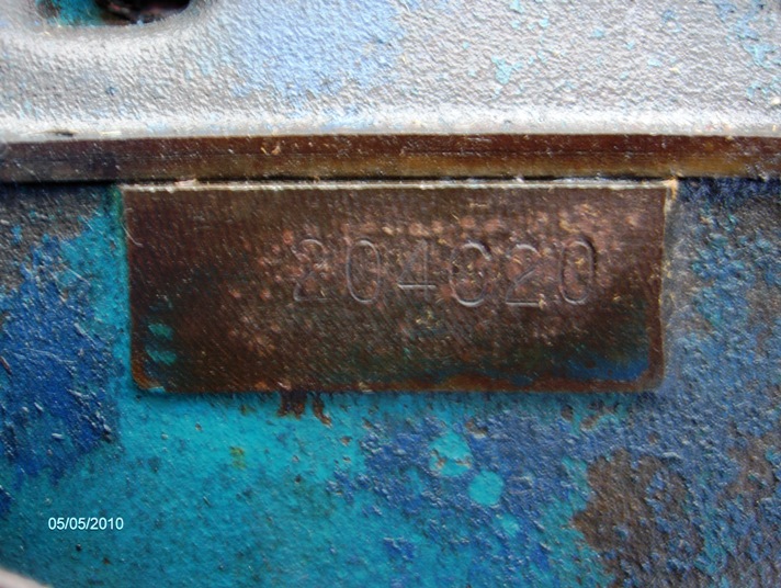

I just recently bought my first Jeep. It's a bit of a Frankenstein: 72-75 frame and 78 body. I originally thought the engine might be an '82, but looking at some of the decoders online, I'm thinking it might be the original '78. The code on the engine block is 204C20...2bbl carb, April 20th, 1978? I'm not sure what type of Carter is on there now.

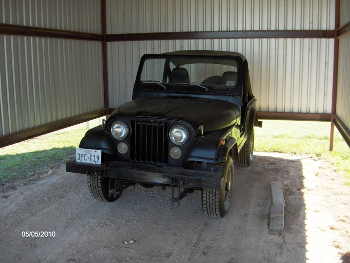

On edit: I just took some pics...here they are. Also found out that the Carter is a BBD...I've heard not so good things about these carbs. Were these used on '78's? There is no stepper motor on the back of the carb.

Okay, so with no answers, I've done more research and come up with some answers.
1) This Jeep was born as a Golden Eagle. It has the tach, the clock, and on scraping down some of the paint on the hood, I found the "g". It sure doesn't look like it did, when it was new, though.
2) I decided to tackle the vacuum lines and properly plug the ports that weren't used. I also replaced the power drum brake booster valve. Looks much better now.
3) The transmission and transfer case were screeching like banshees, when I would put them in gear. Today I popped the lid off the T-150 and found ugliness...there was practically no oil in it and a milky-looking residue, a sure sign that moisture had gotten in at some point. I flushed the case out real good and cleaned the gears with carb cleaner, then filled that case up with 80W90...same with transfer case. Result was no more screeching, but the bad news is that I don't have 1st gear....it grinds, when I try to engage the clutch, so I'm guessing synchro's are no good. 2nd, 3rd and Reverse work, though.
I also greased all of the zirc fittings, while I was under there.
4) According to the VIN, I should have a 1bbl YF carburetor. What I have is a 2bbl BBD. Also, the plastic valve cover tells me that the code on the side of the engine block, "204C020", means that it's a 1982 engine.
So, the name "Frankenstein" is pretty applicable to this CJ-5.
I love this thing!!!
