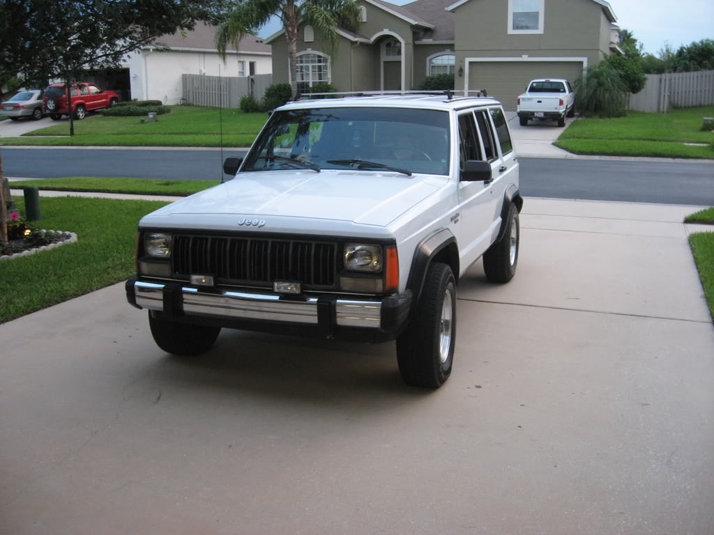

I have a feeling I might get back the money I've put into this car. Once we get rid of the rust in the rear, we can recarpet it (pepboys sells lenghts of carpet that matches the color really well) and refinish the plastic pieces. Also added some nice driving lights:
