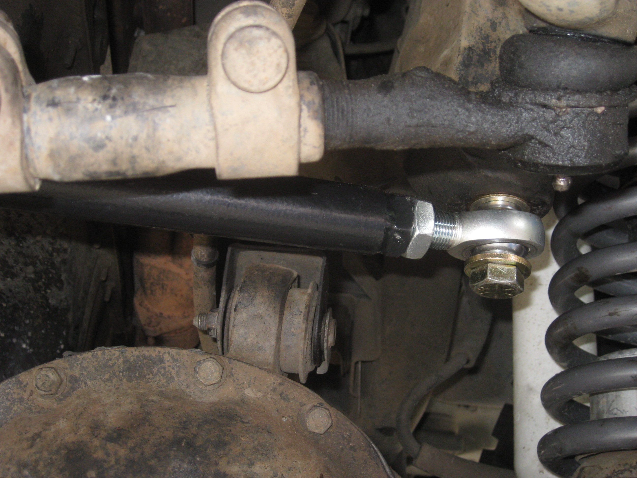

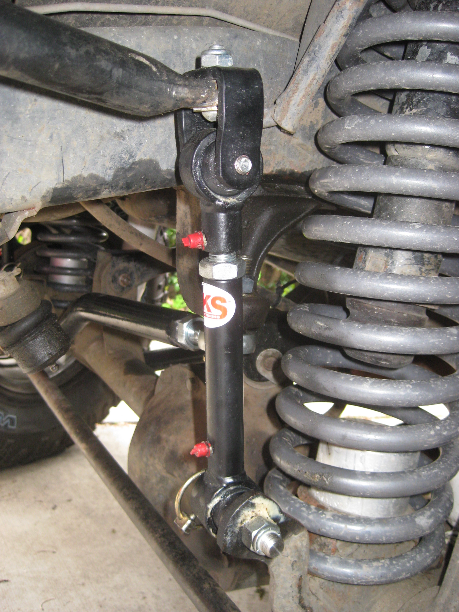

I already have both those, I'm looking for how long people have put them so they are the correct length. If that makes any sense.
This is how they currently look.

Sway Bar
Extend them so your sway bar is pointing about 10 - 15 degrees up. Right now it is going down. Looks like you will probably be extending them 2" - 3".
Track Bar
For the track bar you need to center your axle.
The track bar is used to center the axle you measure off of the knuckle to frame with tires pointing straight ahead measure each side and adjust so axle is centered at ride height

My biggest gripe with jks disconnects, and I have seen it happen to a numbe rof poeple, when they are disconnected, and attached to thaqt little nipple holder thingy you put in the frame, the sway bar will fall down and contact the tire when turning. Personally i would just pony up the extra $100 and get the currie anti rock or something similar. I have heard of people using ford ranger or toyota tacoma torsion bars and making their own.

I posted that mainly because I talk about how to adjust the trackbar at the end of it. There aren't really measurements for the trackbar, you just need to make sure that the axle measures exactly the same on each side.
So, get the axle centered and the trackbar is good
Let your swaybar discos out so that the swaybar is pointed up at a 10 to 15 degree angle
and you're good.
