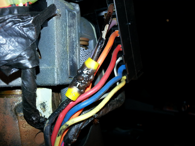

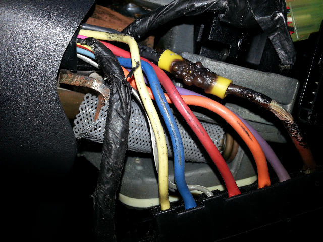

Found the problem guys

Congrats!! there you go, you found the problem. You can replace that electrical connector on the ignition with the wiring. The best way to replace it is to splice the new wires in with a metal crimp sleeves then solder them before you slide a shrink tube to insulate it. I'm not a fan of crimp connectors since i see a lot of failures with them after a short while specially on high amp circuits.

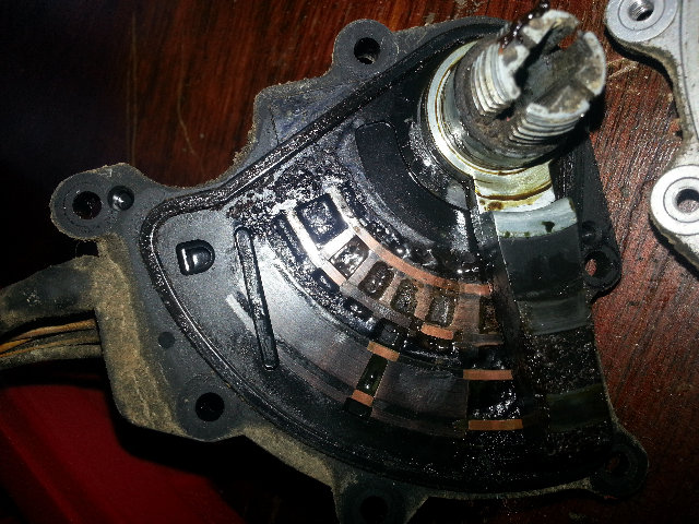

So I'm still having the same problem so I took the nss off an opened it up..is this normal?
