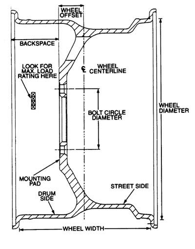

thanks for the suggestions guys. ive been looking online and stuff and i keep seeing something called backspacing, i saw that term on many different occasions and am confused as to what it means. thanks guys
The backspacing is the distance from the wheel mounting flange to the inside edge of the wheel.

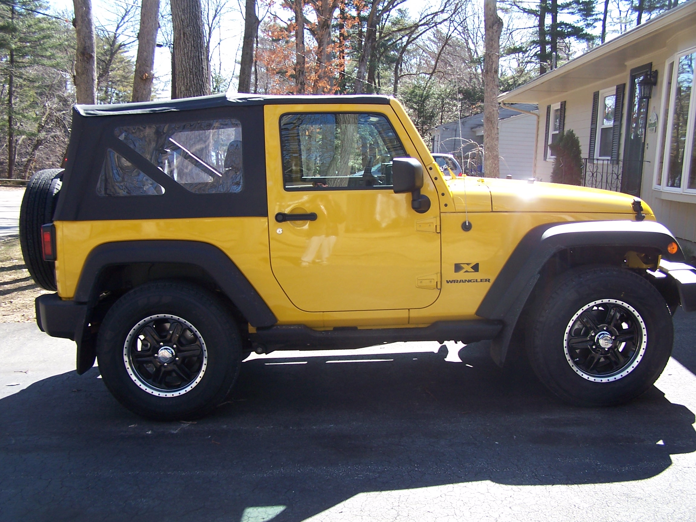

I got a set of black with chrome outline 17" AR ATX, with Pirelli Scorpions 255X17X75R. I think it looks decent.

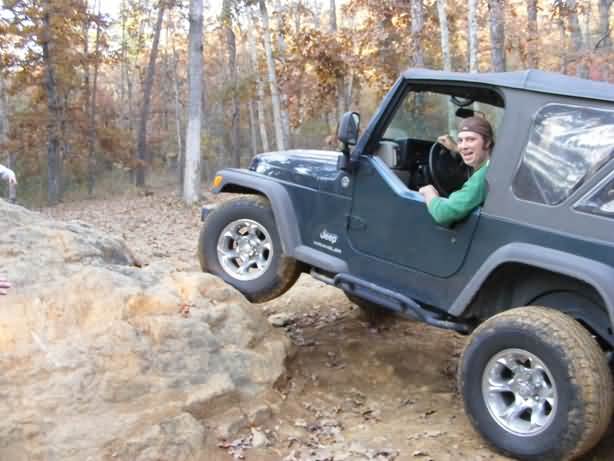

My TJ had chrome rims on when I bought it, and they've really grown on me.

Backspacing is correctly described in jeeper99's post.
It is very important to make sure the backspacing of your particular wheel is appropriate for your tire size and lift. The smaller the number, the wider your stance will be.
The taller your lift and or tire combo, the less backspacing (wider stance) you should have to maintain room for the tires to steer and to keep the jeep stable with it's higher COG.
