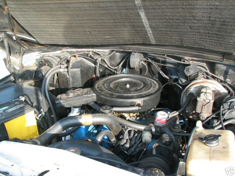

Here's a J10 bay with a 401 engine:
not sure how much thos photos will help, but I figured I'd try.
