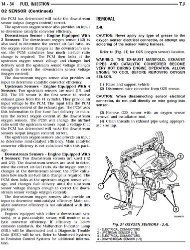

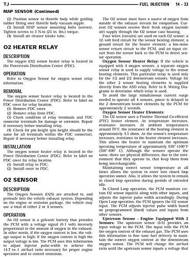

You have inspected the wiring? Do you have exhaust leaks?
Check the fuse and relay below. Not sure 01 is the same but worth a shotThe next step would be to hook up a scanner that you could see the O2 switching. Or pull an O2

Thanks so much JPNinPA. I will give it a go when I get a chance. This weekend, I stopped clearing codes with the MIL light on. I was getting all these mixed 02 heater related codes. Funny , today I get in the WJ to go home and MIL light was off. So I checked when I got home and there were several various 02 heater related codes in memory but no MIL Light. I left it alone for now. It feels like a wire connection of some type. All the monitors haven't cleared so it still won't pass inspection.
