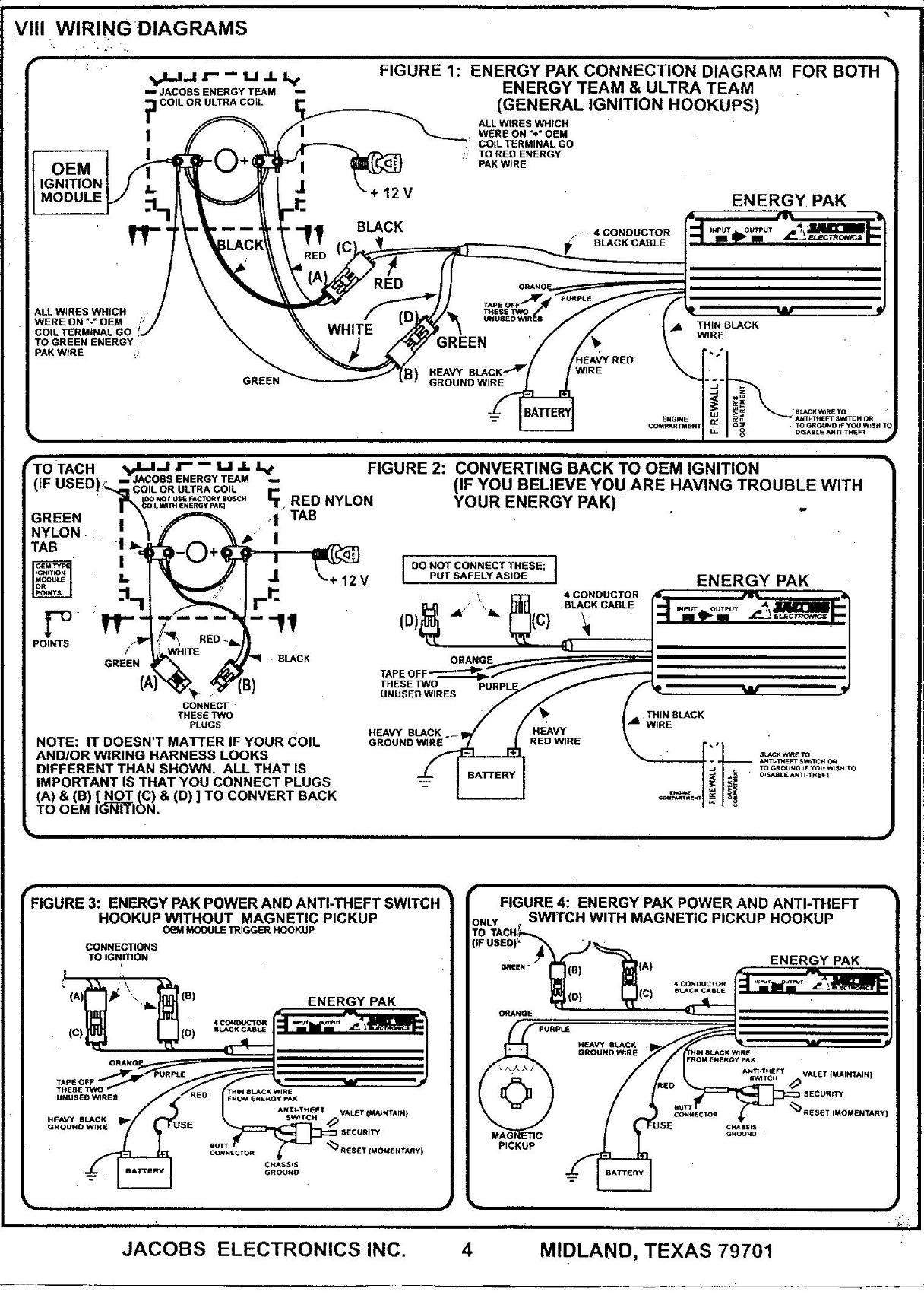

hellbound New member Jun 26, 2009 #1 Does anyone have a Jacobs ignition on their rig?im looking for which wire to connect the tach.thanks
M mcmud New member Jun 28, 2009 #2 Maybe this would help Attachments jacobs ignition #1 jeepz.JPG 520 KB · Views: 2,248 Last edited: Jun 28, 2009

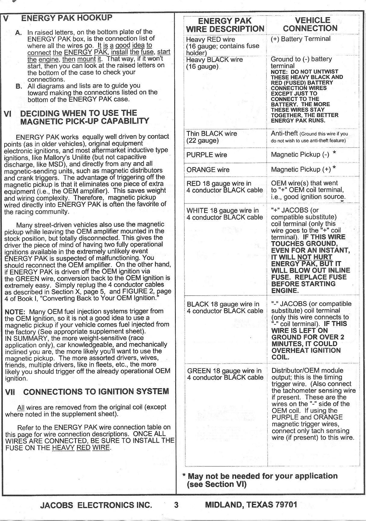

M mcmud New member Jun 28, 2009 #3 --------------over------------------- Attachments to jeepz jacobs ignition diagram.JPG 406 KB · Views: 3,424 Last edited: Jun 28, 2009
M mcmud New member Jun 29, 2009 #5 Sure thing. Notice this instruction is using the Magnetic Pick-Up for signal, rather than a trigger. If this is not all you need, let me know.
