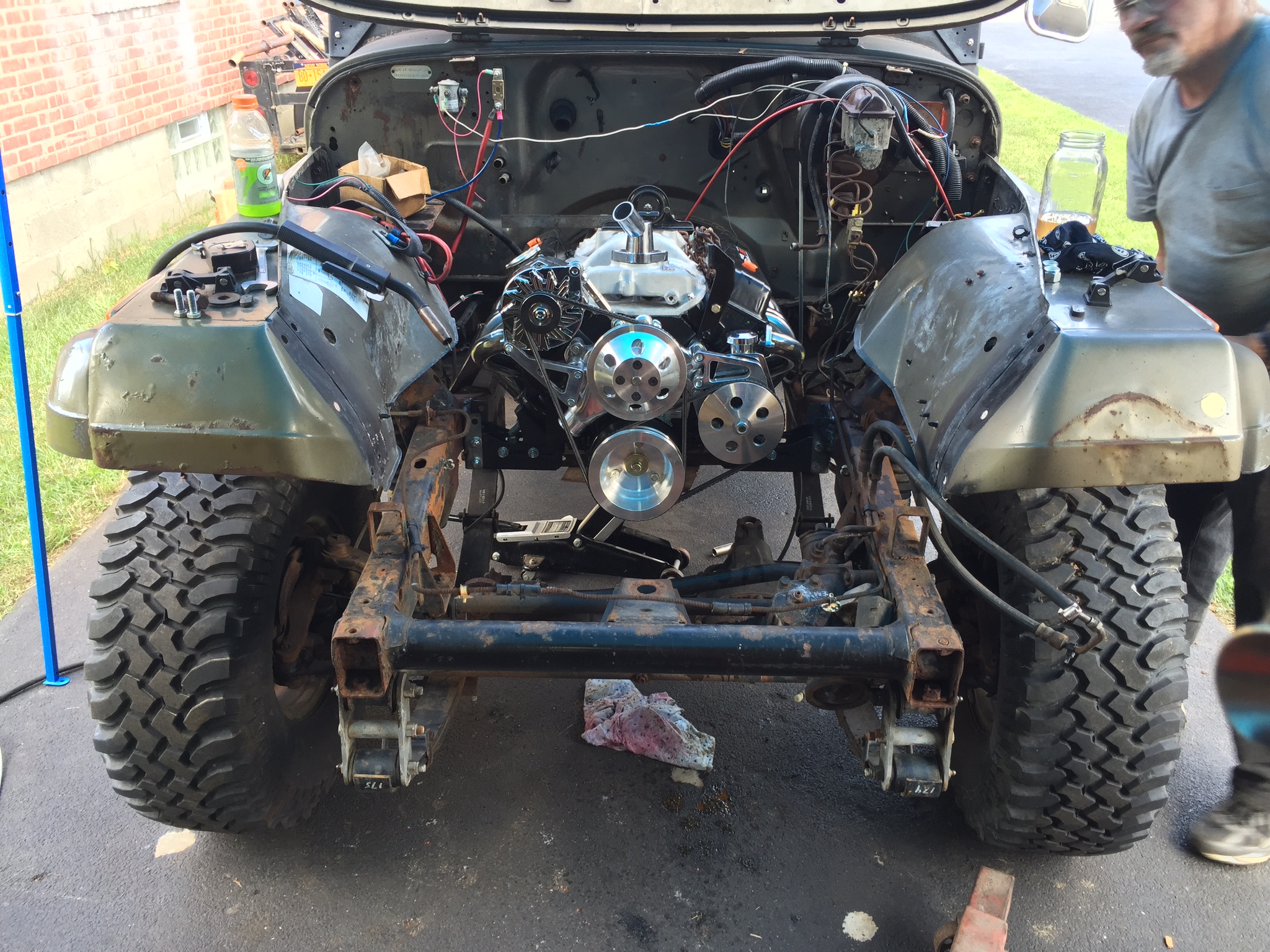

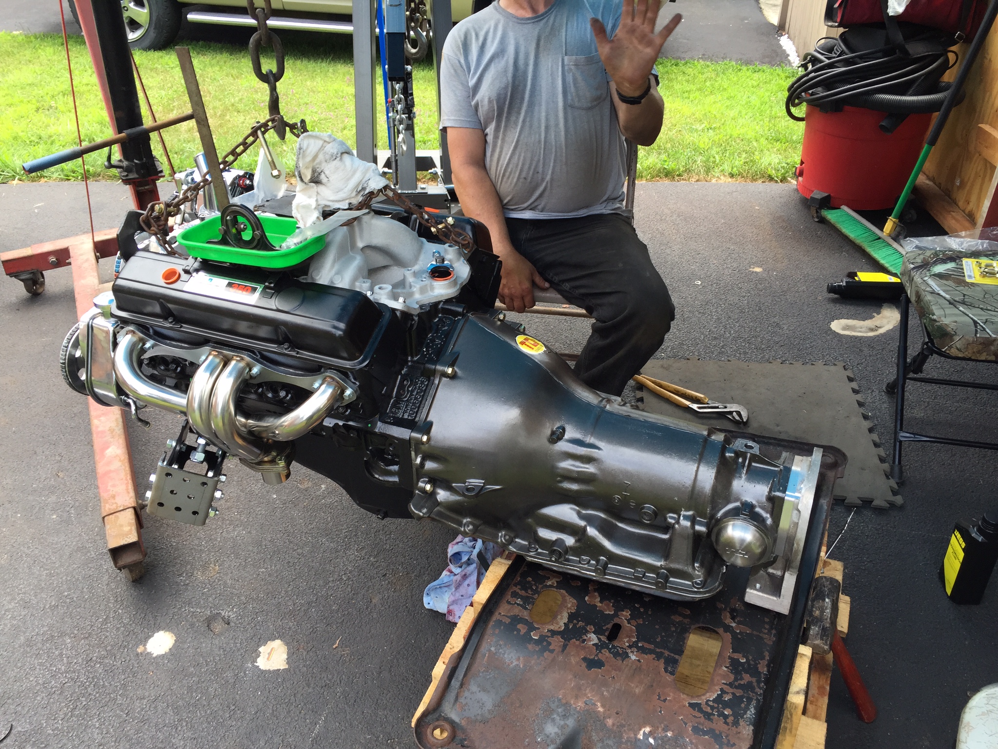

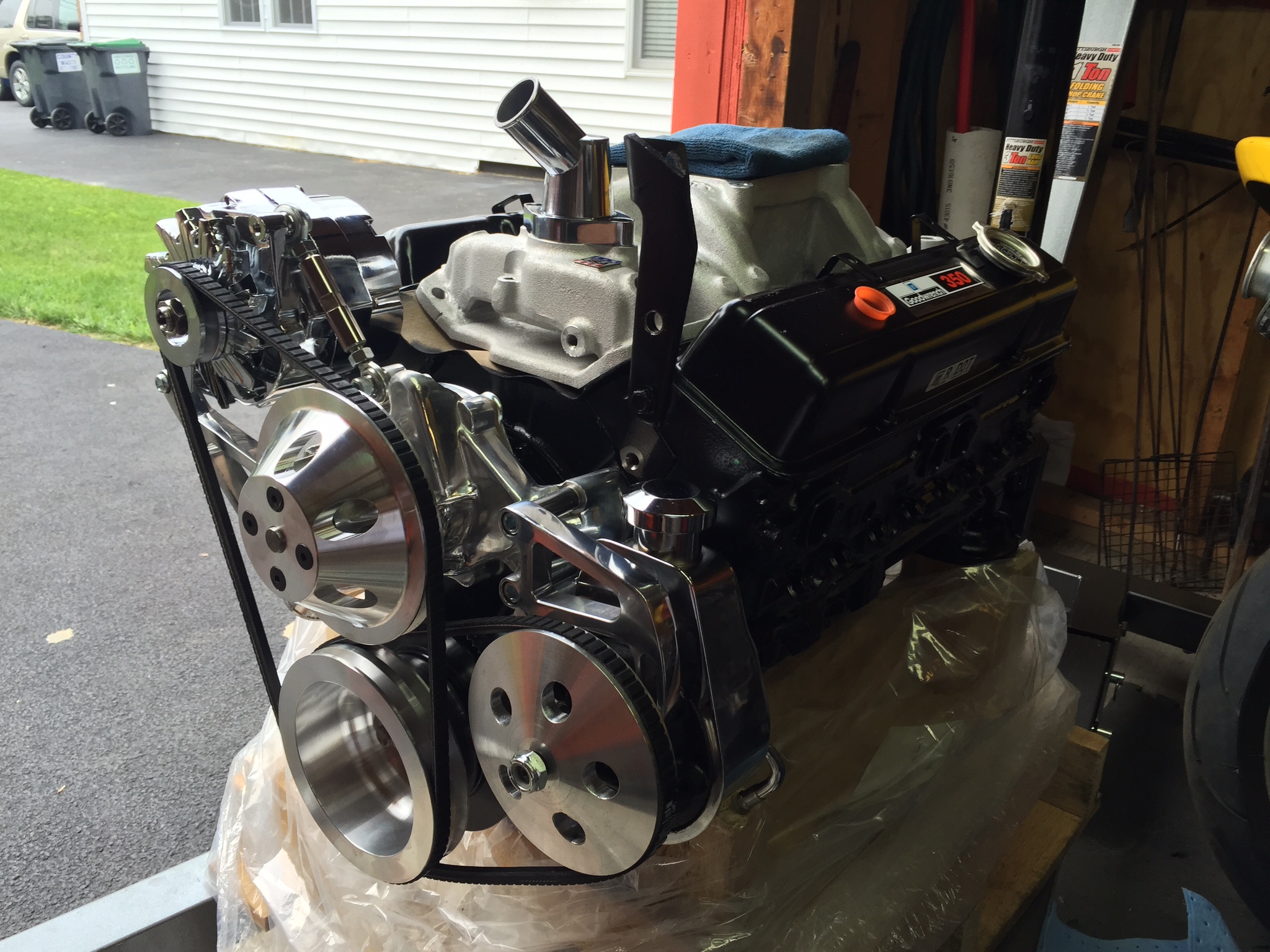

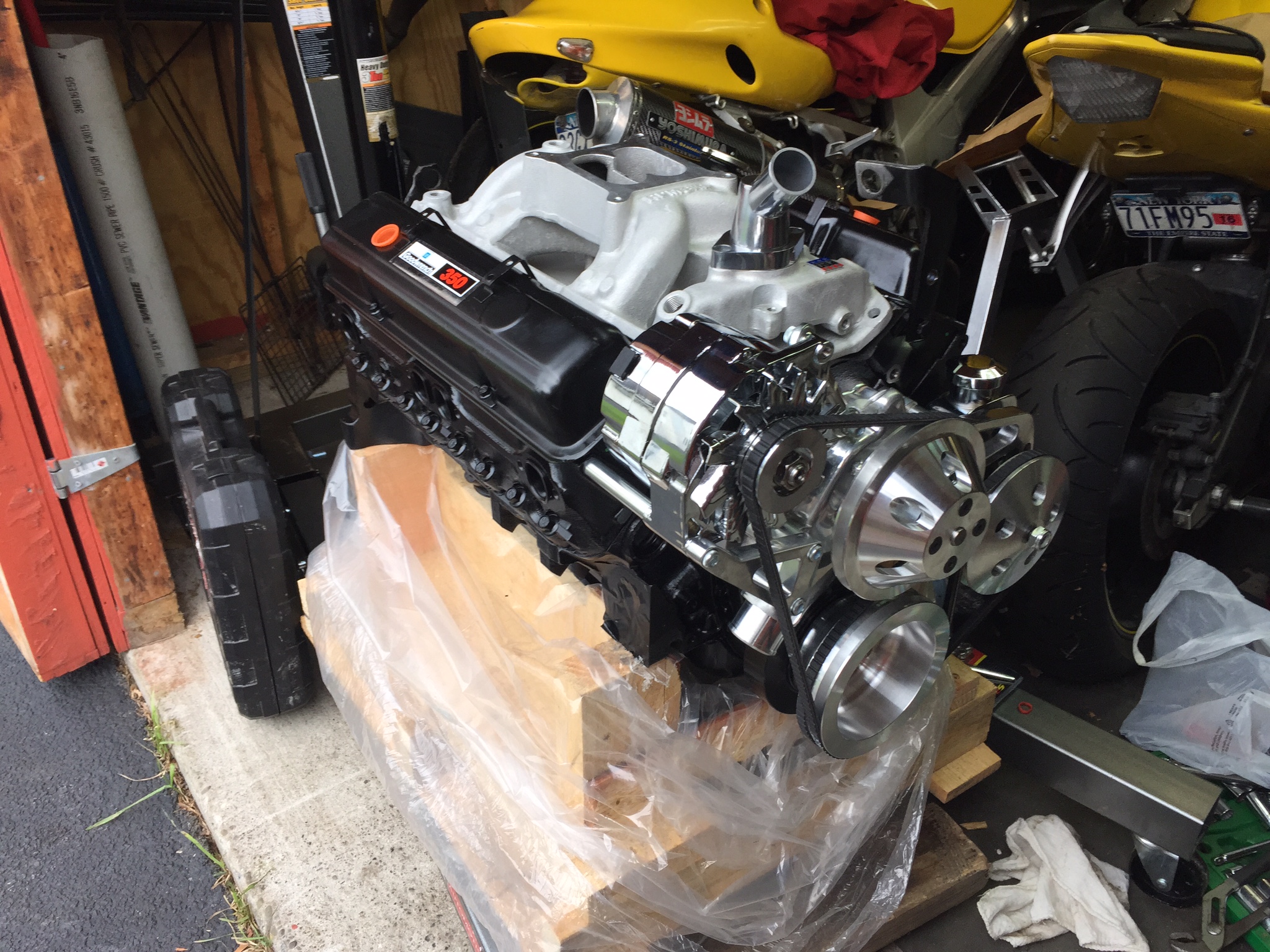

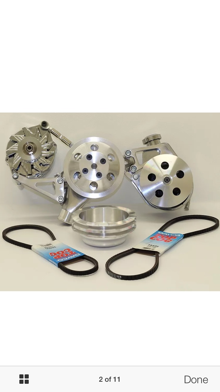

I snagged a TCI Maximizer 4wd trans and a goodwrench 350 engine from JEG'S and bought a package deal water pump/ alternator / power steering pump with matching pulleys off eBay. The water pump leaked from the back gasket right off the bat. The power steering pump didn't have the right type of high pressure line fitting in it. So I swapped the fitting from the old one and resealed the pump gasket. Next I bought a cheap eBay aluminum conversion radiator. No problems ther. Lol.
Pep boys is NICE! I got the MSD hei distributor along with a but load of fittings and little parts. The Edelbrock RPM Air gap intake, Edelbrock AVS 4x4 off-road carburetor, braided fuel line and filter. Nuts, bolts, gaskets,ect. All from pep boys. The wife cringes every single time I go there.

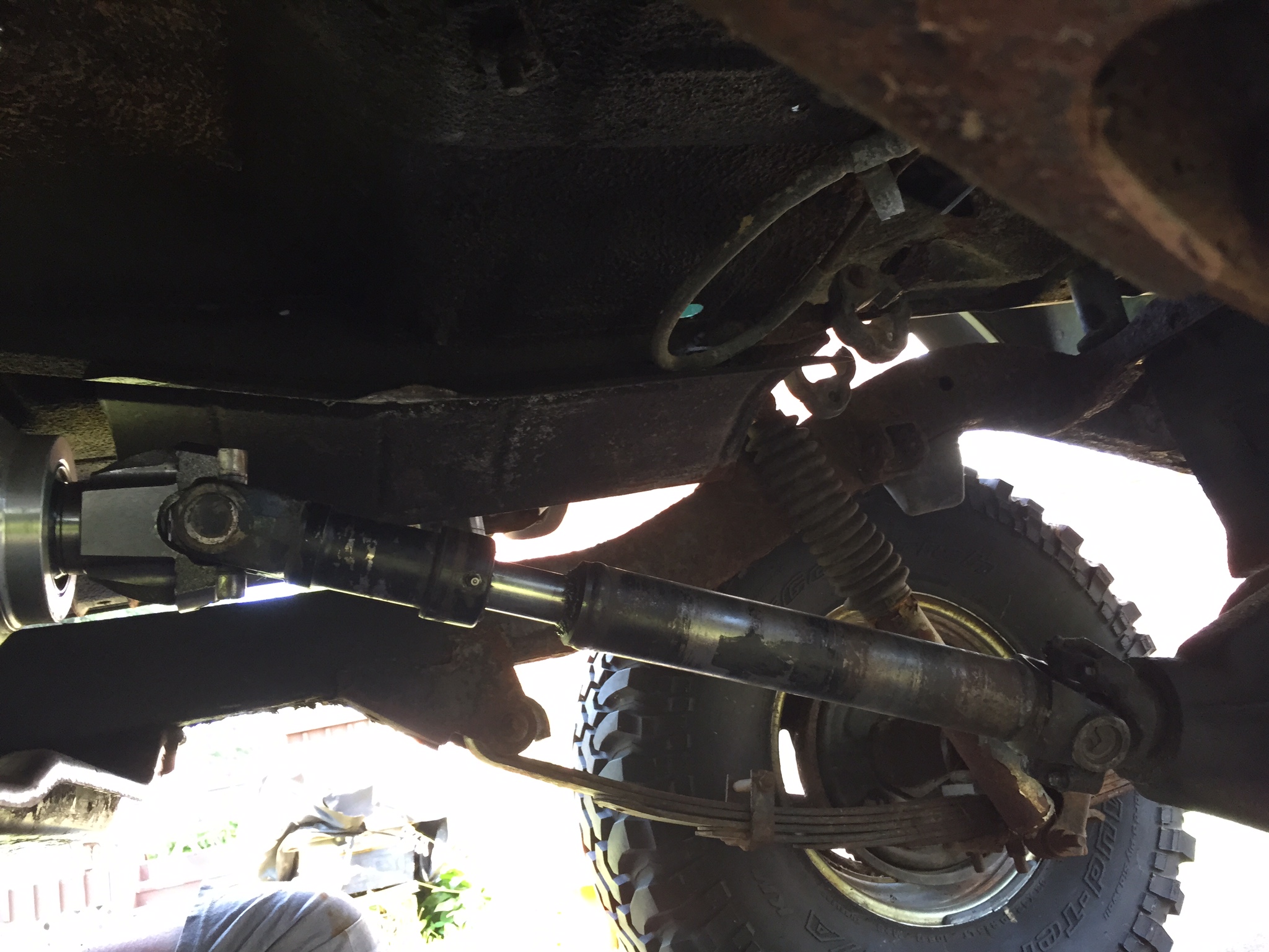

Fuel pump so a mechanical holly big end high flow one - eBay. Novak did the engine mounts and trans to transfer adapter. I welded in the engine mounts and made. An off the shelf mount work for the trans to belly pan mount. Oliver's driveshafts from eBay made me a rear drive shaft cheaper than almost anyone else's and it bolted right in. Got a lot of photos to post just need to get them on here.

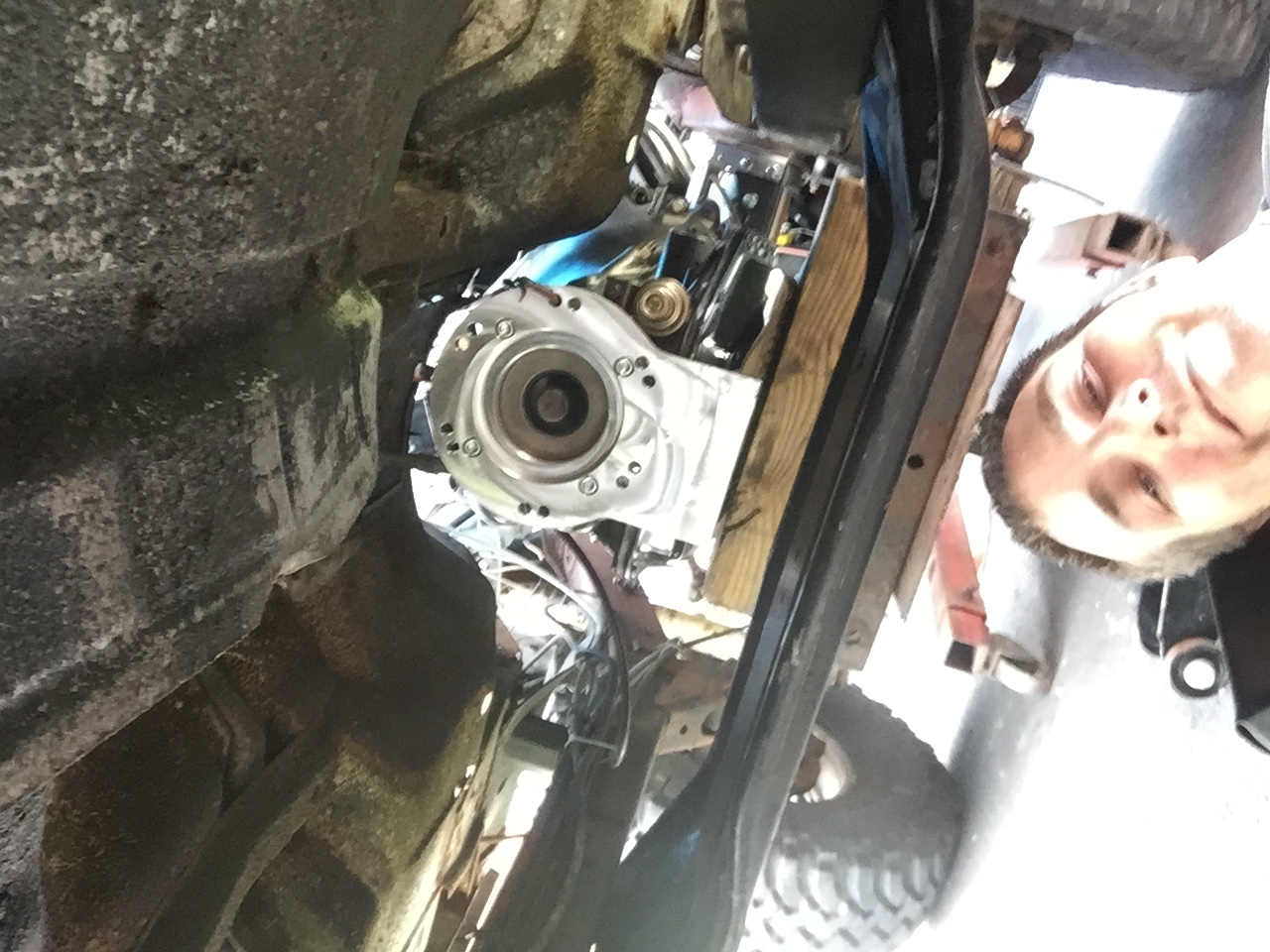

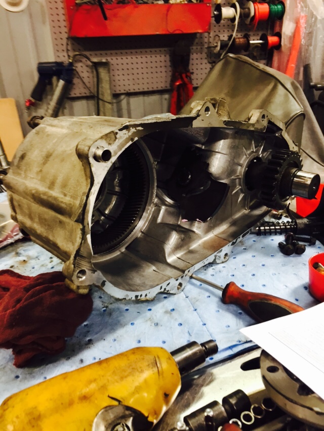

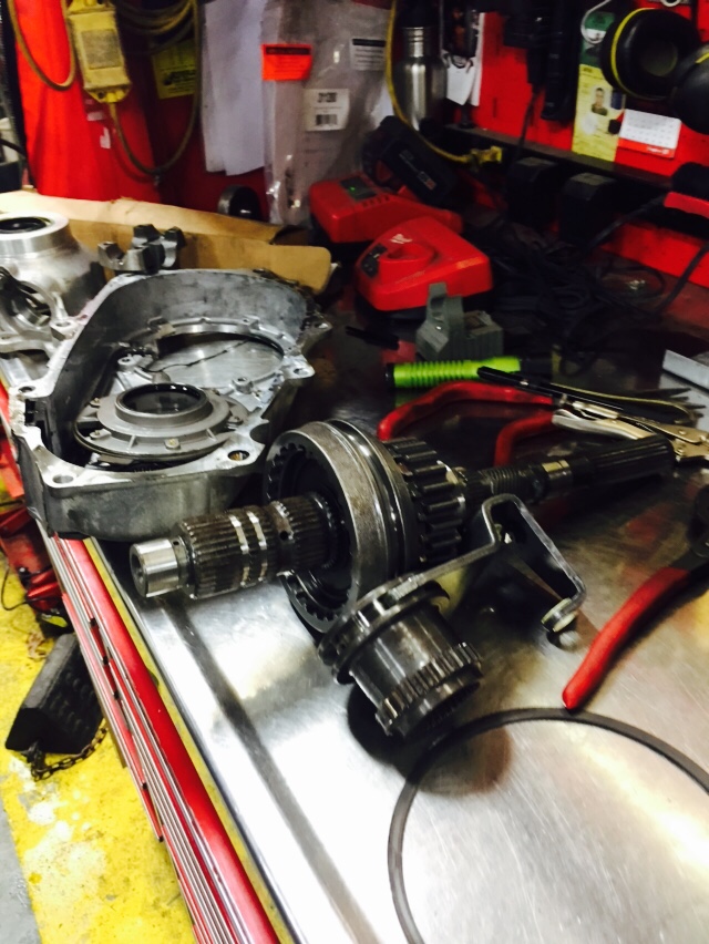

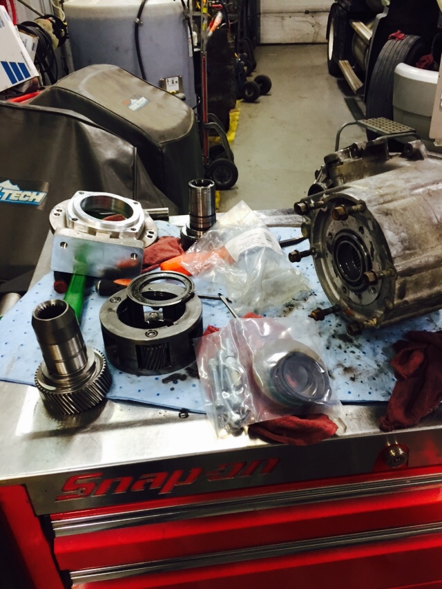

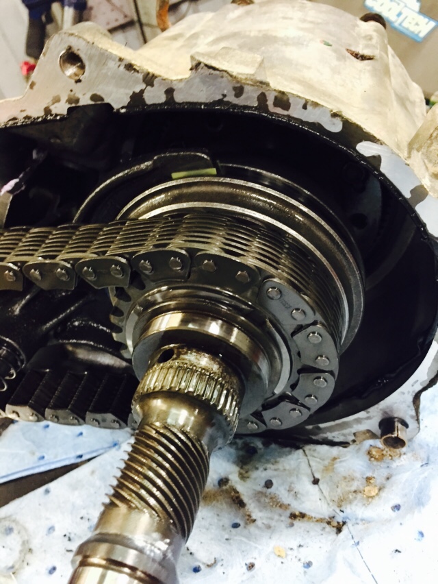

Rebuilding the transfer case. Installing the th350 to np231 input shaft and doing the sye for this case. Easy as pie.

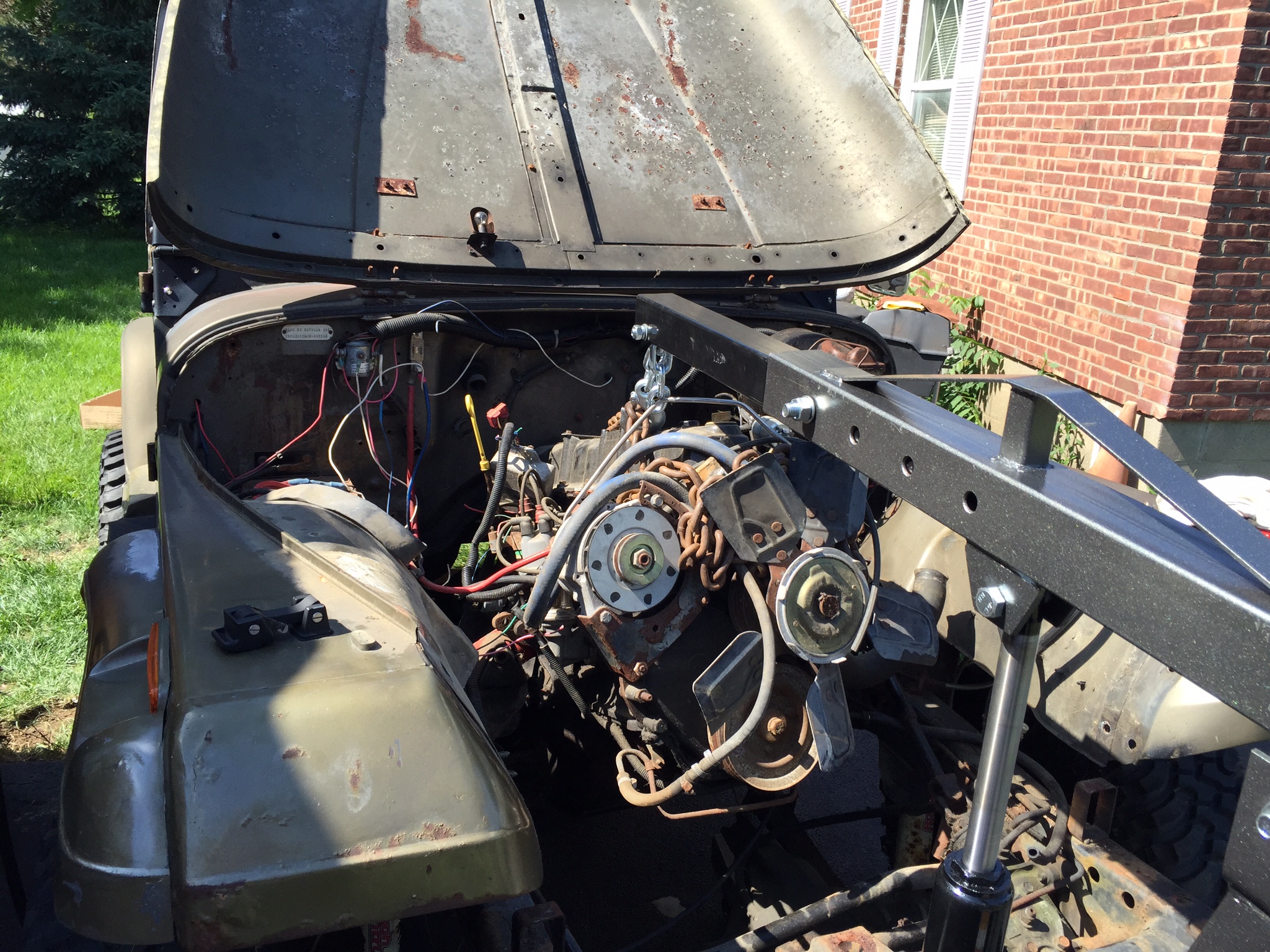

Also pics of me and my father tearing the old 258 out and the eBay accessories drive I bought.

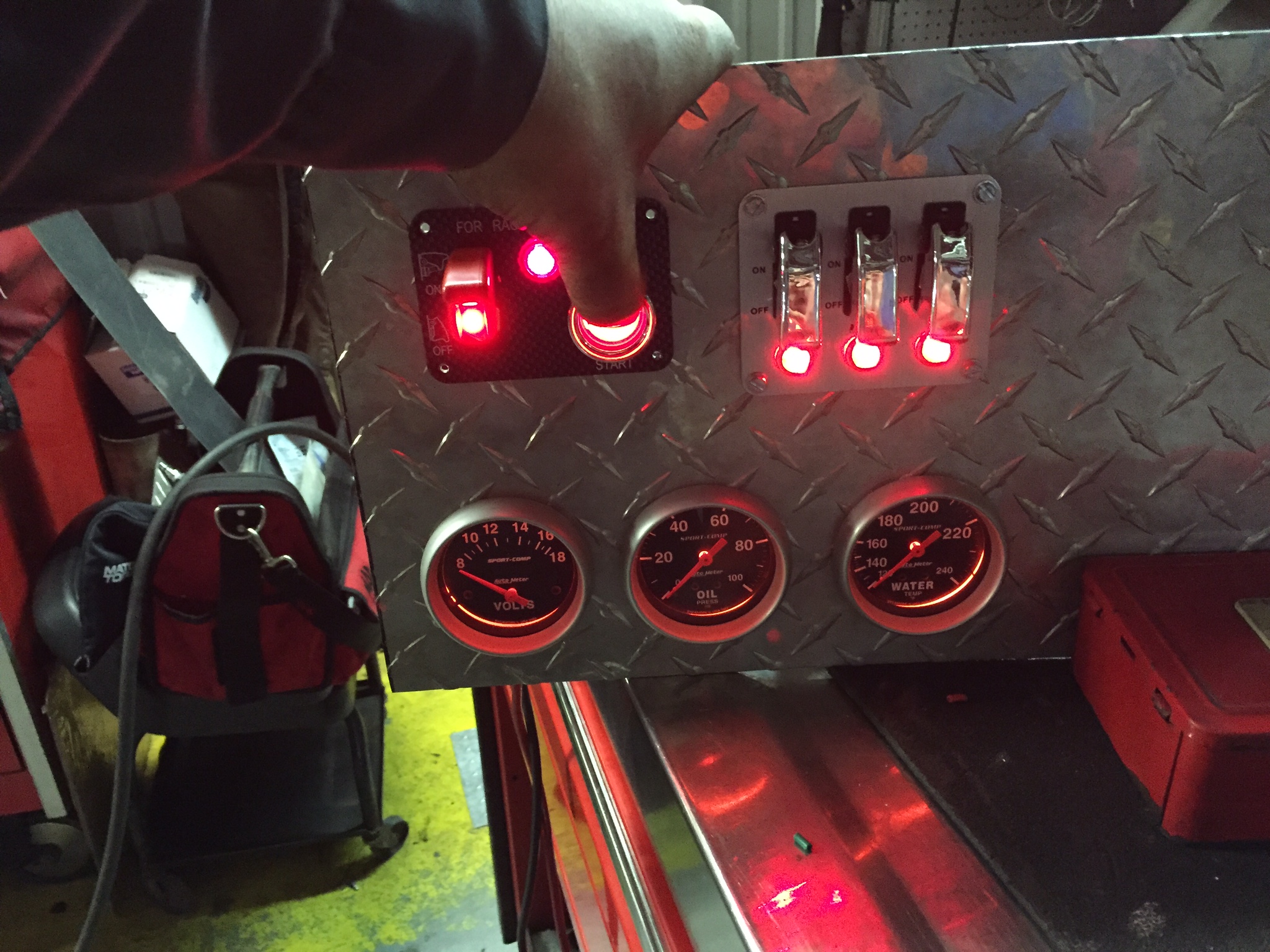

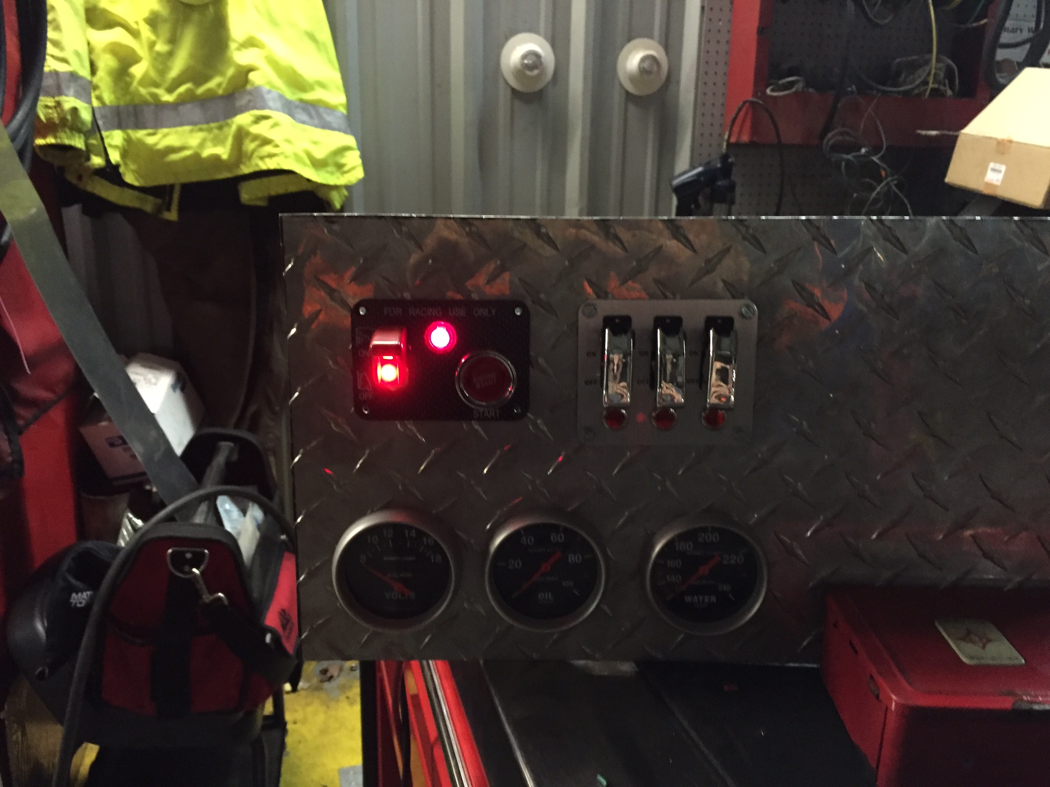

Photos of the transfer case out put, the mock up driveshaft I made, and the dash panel I'm making for the diamond plate dash and center console. Nothing much. Just auto meter gauges and I have a history ratchet shifter I had sitting around. Gonna mount it just off the dash kick out under the gauges. Plenty of room for more toggle switches and stuff. I have gutted the wording once already. I guess it's time for a second cutting. Gonna start fresh.

I like the gauges and lights. That's gonna look sweet.

It was still cheaper to get the crate than rebuild one. I had a free 305 to use but after turning the crank, magnaflux ing the block and getting new heads I was a couple hundred over the crate engine
Lights, gauges(sport comp), toggle switches, and push button start switch all at pep boys. They have some good stuff. The push to start switch actually is pretty well thought out. You can disassemble it while it's in the dash and clean the contacts without removing the whole switch, or unhooking the wires. Still has a key. Just in case someone wants to jump in and take it for a spin. Lol
