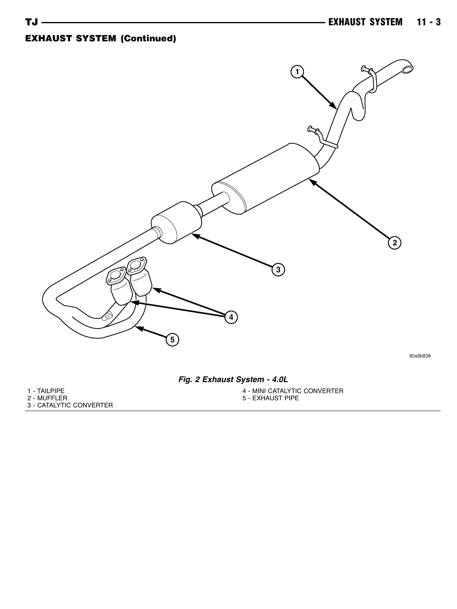

I haven't been on the forum for quite some time but I recently started having trouble with my entirely stock (I know it is sad) 2004 Rubicon (4.0L TJ). I have approximately 76,000 miles and do routine oil changes and maintenance. The problem started when, at normal idle, I was hearing a metallic knocking sound. Using an automotive stethoscope I narrowed the sound to coming from the exhaust system, specifically near the front (engine side).
Shortly after this it started throwing codes and the check engine light came on. Using a code reader I found that it was showing P0302-CYLINDER #2 MISFIRE and P0303-CYLINDER #3 MISFIRE. I replaced all the spark plugs and inspected the old ones and saw nothing unusual (clearly not an expert though) and still have the problem. I also inspected the coil rail and it appeared to be fine.
The Jeep runs okay as long as I do not accelerate hard or put a load on it. As soon as a load is put on it, it loses power, starts bucking and the check engine light begins to flash.
I am thinking that my mini-catalytic converters are plugged. Does anyone have thoughts on this? Also, if it is the mini-catalytic converter, instead of replacing them (approximately $400) what about clearing out the obstruction and re-installing them? Will this cause problems for my engine computer or for emissions testing?

You need the cats to run properly. Hallow them out and you will have issues with warmup and mpg, throw more codes and be breaking federal law. They are more likely to fall apart themselves before they clog. I doubt they are clogged unless you were burning oil or gas with lots of additives.

So I finally had enough time off to work on the Jeep. I got the mini-catalytic converters off and they had in fact melted and plugged up the exhaust. I ordered a new set up which should get here Friday. For now I chipped out the honeycomb section and the Jeep runs perfectly. It does not throw any codes and no misfires! It does show an "error" on the catalytic converter which should be fixed as soon as the replacement is installed. Thank you all for the assistance.
