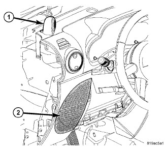

1.Disconnect the battery negative cable.2.Remove the mounting fastener.3.Remove the tweeter (1).4.Disconnect the electrical connector.

5.Disconnect the electrical connector.6.Remove the mounting fasteners in the left side of the instrument panel.7.Remove the speaker mounting fasteners.8.Remove the speaker (2) by carefully pulling the left side of the instrument panel outward until there is sufficient room to remove the speaker through the end cap area.
