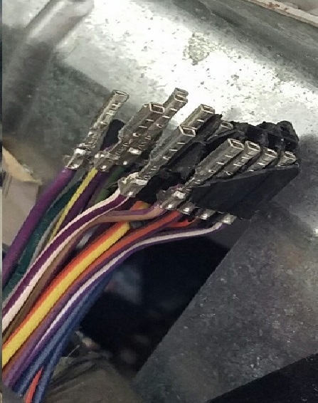

Usually pins are compressed metal and spring like. After some time and weight....the spring relaxes then bends until no connection. So the blade end may look fine but the opposite is the issue. I don't know how much space is there and if you could do this and monitor at the same time. But you should be able to wiggle or push the each wire connection from the backside to determine if it is one pin.
Pic from a broken connector
