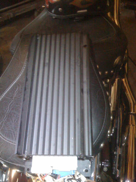

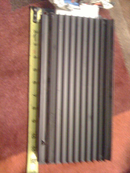

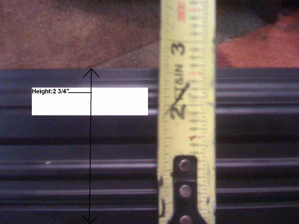

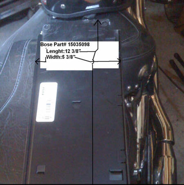

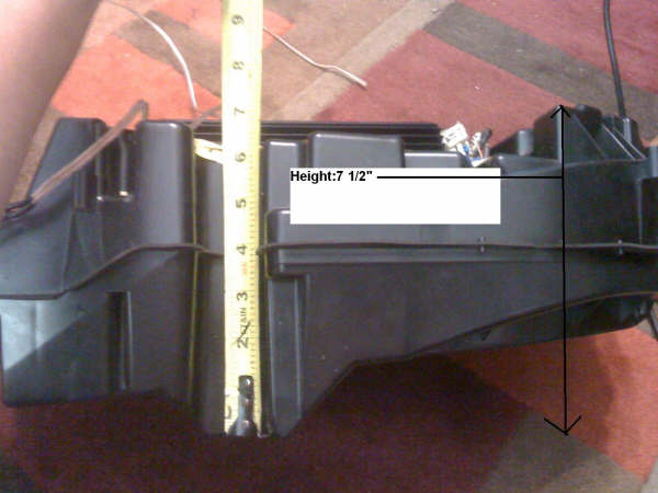

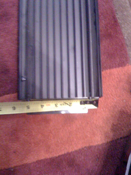

The Bose Amp
Here are some shots of the Bose amp from a 2002 GMC Yukon Denali.
These are easily found on GM vehicles equipped with the premium Bose sound system. The newer ones use the same amplifier but a different subwoofer (a little bit bulkier.) The speakers on the newer subs are similar in size with the TJ factory console subs.

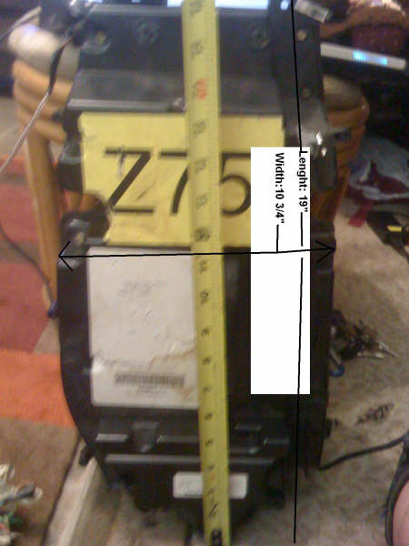

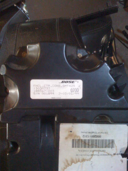

The subwoofer
And these are a few shots of the subwoofer and enclosure, also from a 2002 GMC Yukon Denali.
Dimensions are given with the pictures. This is the set up I have on my 81 CJ7, mounted behind the dashboard out of sight from unscrupulous individuals that might think of something bad. It’s a crisp and deep bass sound with 2 Kenwood tweeters on the top dash, 2 6X9 Blaupunkt speakers on the roll bar. It could probably use another pair on the doors for more midrange, but that depends on the radio you pair up with this setup. The radio I’m using is a Pyle AM/FM/AUX/ CD player Marine. You can adjust the bass, treble, midrange, front and rear. Amazingly enough, the amplifier works better with a radio that has a low level output. The subwoofer fits perfect in between the front seats as well. The only thing you will need to do when mounting the sub wherever you choose is to fabricate some brackets. The subwoofer speaker enclosed in the box measures 6 7/8”x 4 ¼” and 3 ½ “ deep.

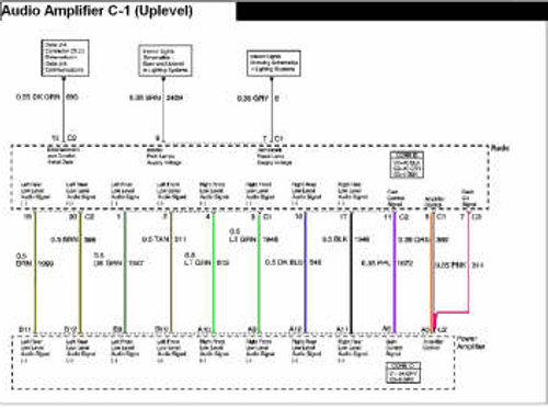

The amplifier connectors can easily intimidate anyone that is electronically challenged. I hope I can talk you out of that after this Basic electronics 101. As a rule of thumb in wiring color coding, red is a positive polarity lead, black is ground, orange is a switched positive lead and blue is a switched positive signal from another component. The step-by-step is pretty simple as long as you follow the color-coding from the diagram to the actual amplifier wiring.
NOTE: Not all of the wires will be used on the amplifier connectors.
I've attached the aplifier wiring document - take a look at it and compair to your amp before you begin.

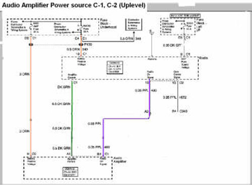

Powering the amp
The first step in wiring this system up is to get power to the amp. Remember to disconnect the battery from your Jeep before doing this.

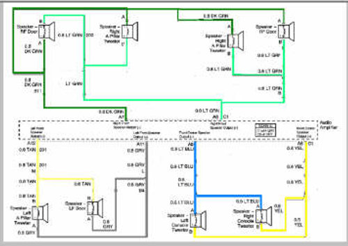

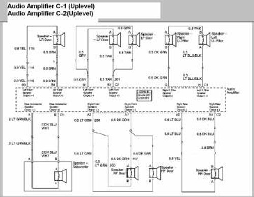

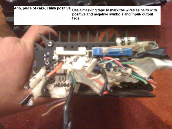

To better aid yourself with this project, use a narrow masking tape and a Sharpie black marker and sort out the wirings on the connectors according to the wiring diagrams and mark the wires as pairs. For example, Pin A1, A2, which is DK GRN and LT GRN is the right front speaker output, positive and negative.
Viewing the amplifier from the connector ends, heat sink upwards, there are 2 sets of connectors. The connector on the left is an 8 way (C-1 Connector.) It contains the orange (switched power), black (ground), light brown and purple (left rear output to speaker), white and red (left rear midrange) to speaker, Lt. Green / black and dark blue/ white is the output to the Bose subwoofer.
The connector to the right is a 24 way (C-2 Connector). Use the connector pin reference guide. The top row (12 pins) is numbered A1 thru A12. The bottom row is from B1 thru B12 pins. Pay close attention to the pin numbers corresponding with the wire colors so that it doesn’t confuse you. Pick a radio of your choice and wire it up with the amplifier. Install the amplifier input, outputs and power supply only. All the RSA (rear seat audio) controls and remote CD circuits are not used and should be insulated with a shrink tube or electrical tape.

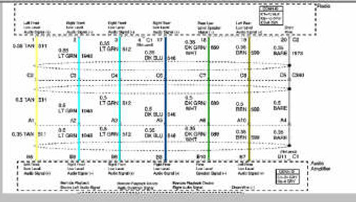

Audio inputs and outputs
Now, you need to wire the audio inputs and outputs. Remeber to reference the install PDF above
