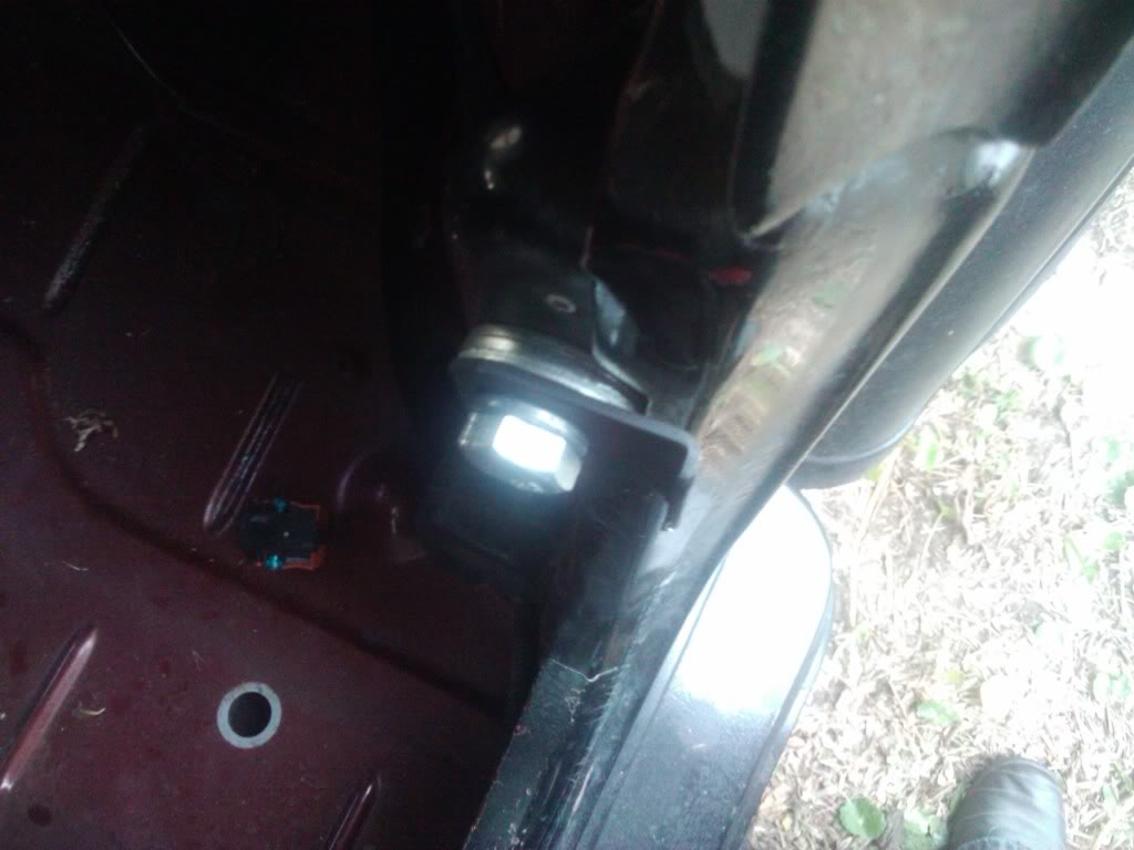

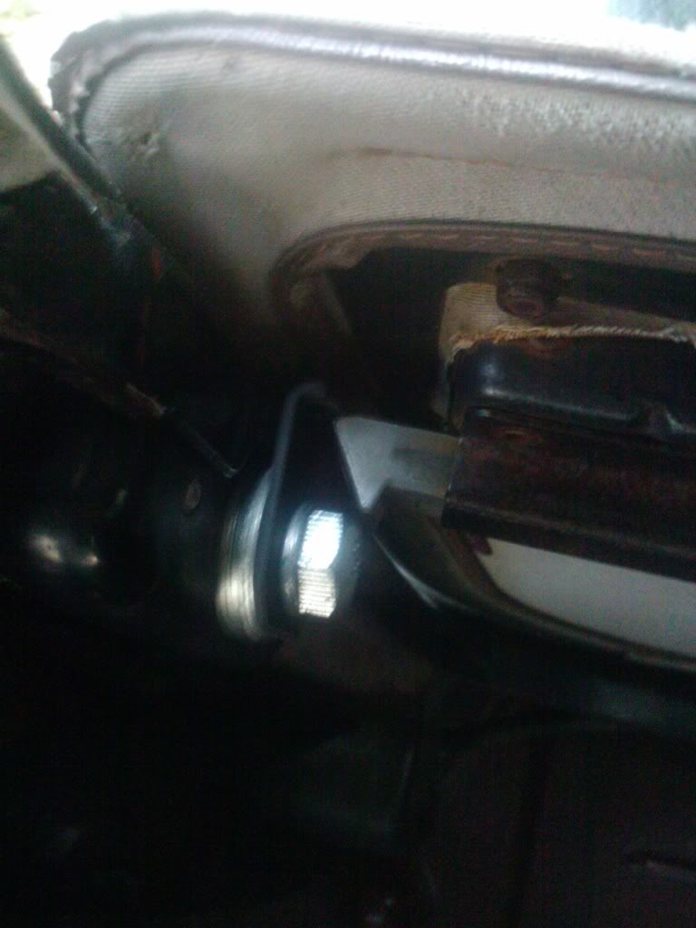

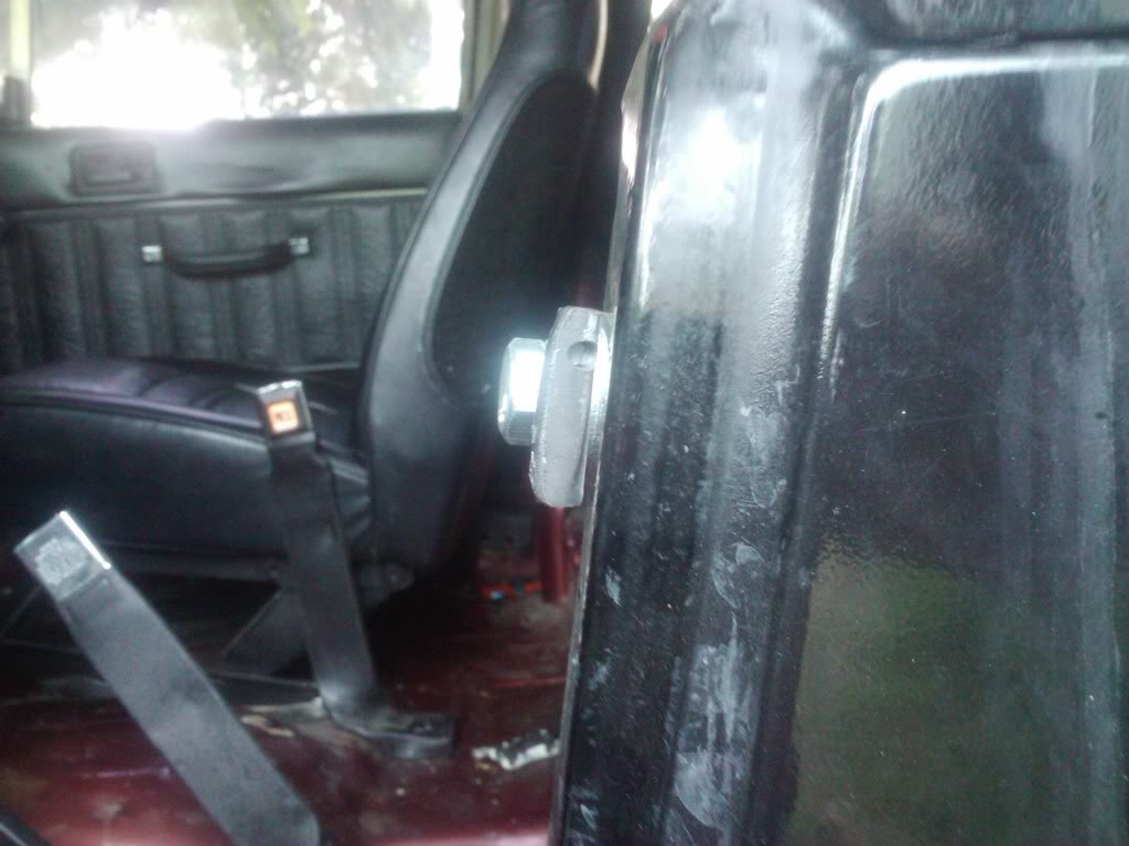

But they are for a yj with a loop or a flat plate to latch to instead of the torx head bolt. In order to make them fit I had to fab my own striker for this other style of latch mechanism. I got the doors for 100 bucks on ebay, super duper cheap. The only negative (to my wife, not to me) is they are brown and my jeep is black. The kids love them, like I do.

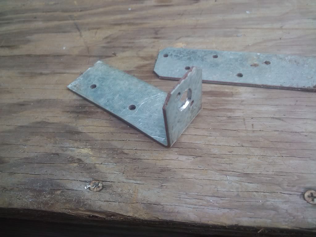

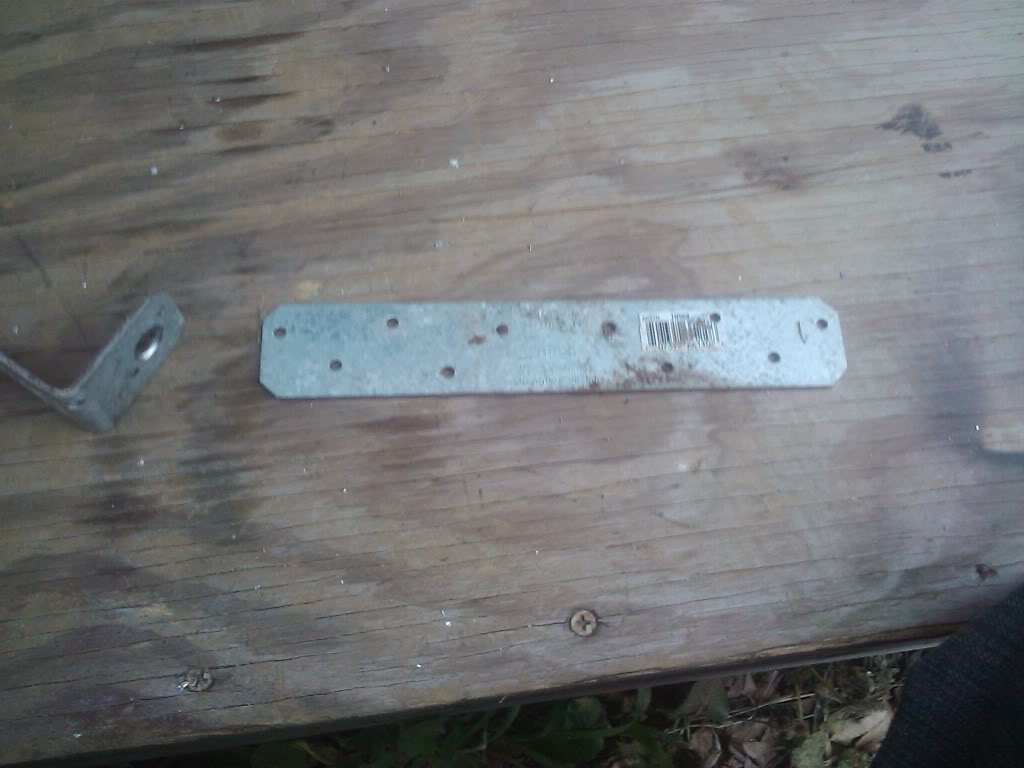

I had some straps from when I built a shed a few years ago so I drilled them for the bolts and bent them to fit the door frame and hold the doors snug.
After some adjusting and some washers to space the piece out, it came out like this
And, the doors work great but I got done after the sun set so I have no pics of the doors installed.
