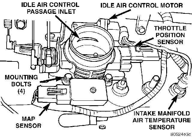

AIS (Air intake sensor)?, that should be on the T. body air intake tube going to the air filter. It's a tiny sensor (2 wire)..

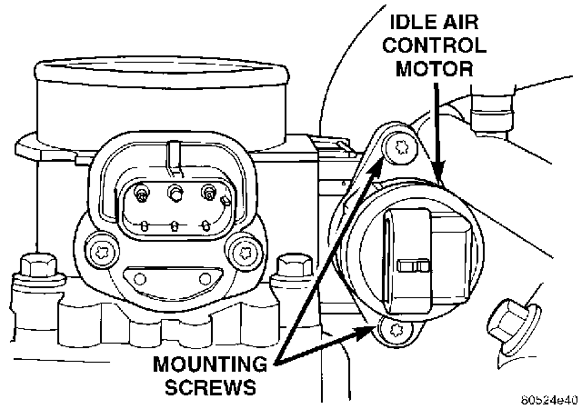

IAC (Idle air Control) is mounted on the side of the Throttle body. the pintle or plunger is possibly stuck.

Well, I cleaned the adapters on the TPS and the IAC Motor and also took off the intake hose cleaned inside the throttle body, opened up the valve and cleaned in there (it was pretty gross).
I put it back togetehr and its running okay now.
