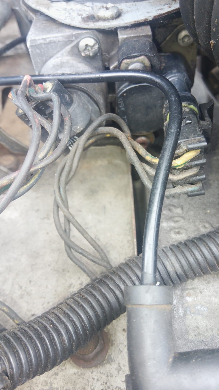

Some of this is going to sound strange I think. After I replace the brake booster and took away the air leak the high idle stopped working. My 4.0 1987 XJ will not idle at all on start up and when it is warmed up and I take my foot off the pedal it goes to an idle of about 500 RPMs on the tach and will eventually die. I know my pump is not holding pressure, the sending unit is bad also, I have a new one but no way to get the gas out of the tank to change it (I am in Costa Rica) I have looked over the throatle body and I do not see any where to set the high idle and idle can someone help I know there has to be a place to do this I cannot find it, please and thank you.
PS, there are no vacuum leaks, I have done a visual and audio inspection of the engine.

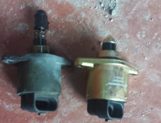

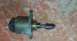

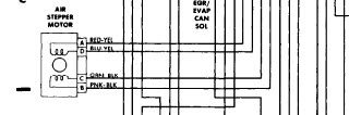

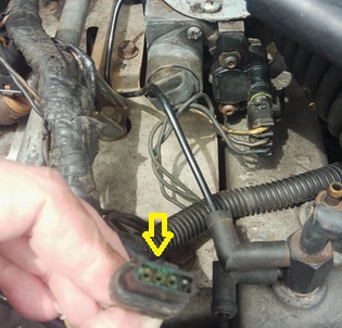

Where is the idle control valve and how to test it?
