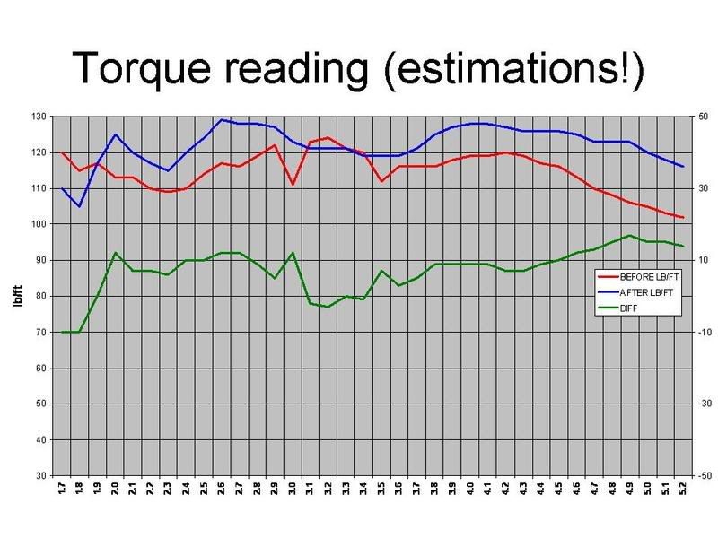

Take a look at the following chart: the red line is the stock 2.5L torque curve (according to JP magazine):
If you notice, the most torque is from 3 to 3.5K RPM, and this is where the little engine that could likes to be at...
You mean AX-5, right? The AX-15 came with the I6, so unless you swapped it, you have the AX-5... And in that case, and my opinion, with the 2.5L and AX-5, the ideal gear ratio for 33's is 5.13 and for 31's is 4.88 (different from what most charts tell you, but based on REAL life experience).
