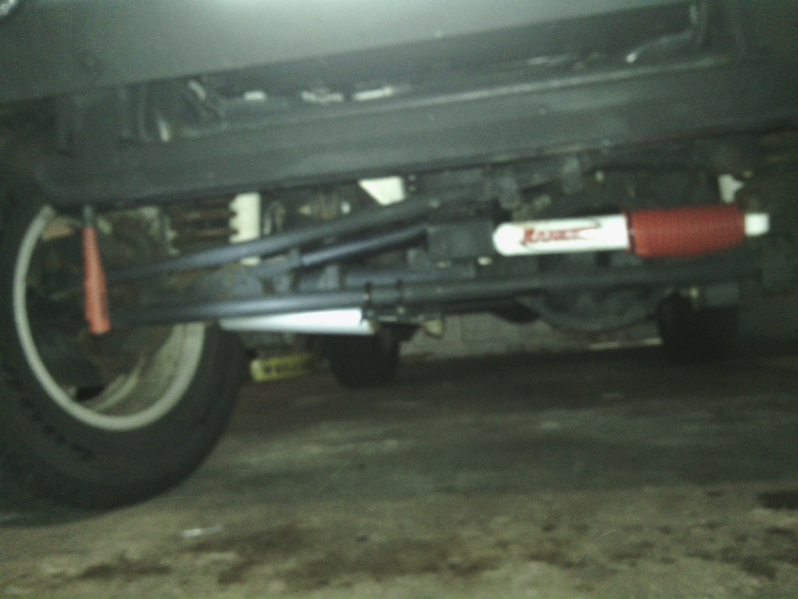

I put a rough country steering stabilizer and relocation bracket on it last year. Didn't fix it with the stock wheels and tires so I added the original brackets back on it with a new stabilizer and lowered the tire pressure to 29 psi. Problem solved. But not after a ton of money to my jeep dealer so they could tell me nothing was wrong with it. I will give many more details of any one is in the same boat.
The second stabilizer is only a bandaid and not a fix for deathwobble. The extra resistance provided by the additional stabilizer is only masking the issue that is still there.
A rig properly setup can run all day long with no stabilizer at all and no DW. The purpose of a stabilizer (steering damper) is to take the shock load out of potholes and other road input, making steering components last longer. Also helps keep the wheel from getting jerked from your hands if an object is struck with the wheels. They are not meant to hide a wobble caused by a loose or worn component.
