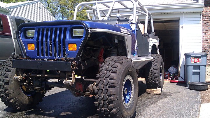

i was bored and thought i would be cool and lay the windshield down and remove those spreader bars. what i am trying to do is just find a hoop, like the older jeeps had so i can hook my shoulder belts to it and then drive around with the windshield down.
just until i can find a family roll bar.

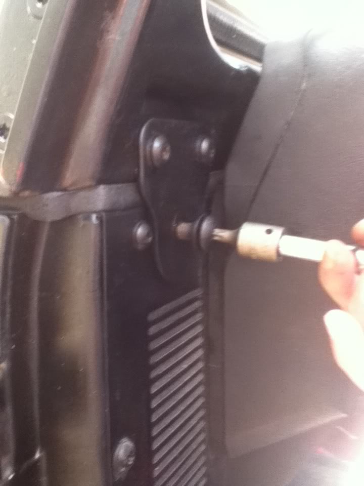

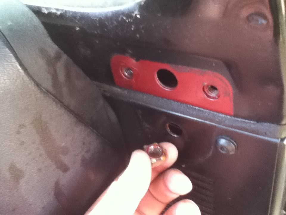

first thing to do is remove this bolt on each side of hte jeep. i actually pulled the whole plate because i had never laid a windshield down and didn't know what i was doing

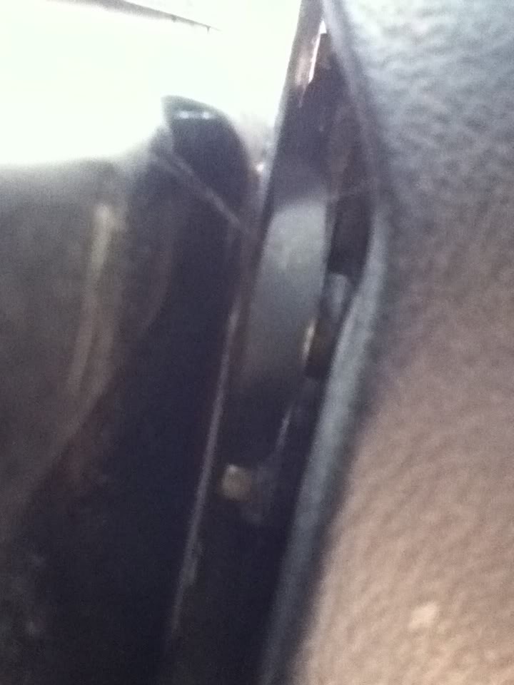

on my passenger side, this nut came loose inside. luckily, there is lots of room up there so i just reached back there and held while i turned the extension
after those bolts, you want to remove the two bolts on each side of the spreader bars in the upper windshield area. once you get the two bolts out, you can just pull the spreader bars outward from under the visor mount

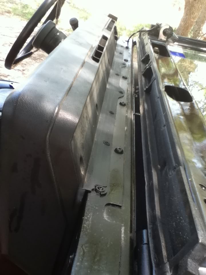

don't be alarmed if it doesn't move, its not this. this is the windshield wiper motor and all it is attached to the windshield and will fold with it.

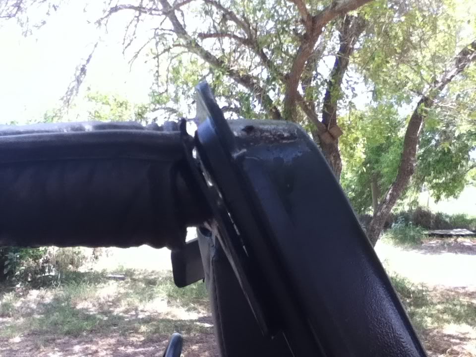

after a fair amount of pb blaster and very careful wiggling back and forth, my windshield finally laid over. it looks like one could very easily bend something if you pushed really hard instead of wiggling it and letting it work itself through the rust and paint in the hinge, so be careful on this part.

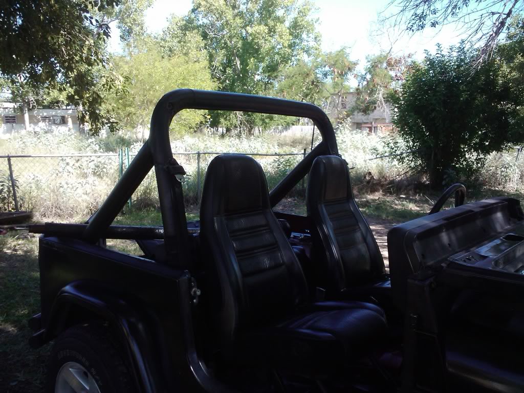

i don't have this bit so i am going to have to grab one today and finish later but its easy, one on each side of the spreader bar back by the hoop section of the roll cage and slide it out

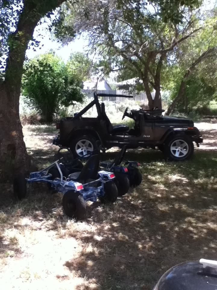

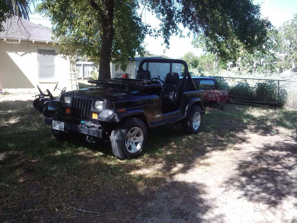

here is where i am at right now
and a nice shady spot in the yard for the ol jeep to sit and hang out till get that bit

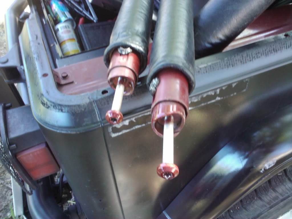

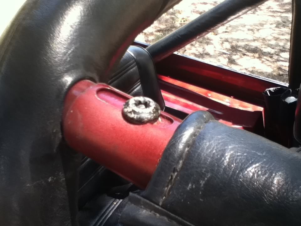

ok, found out you don;t have to mess with that top bolt because there is one on the back side of hte hoop that actually holds the spreader bar to the hoop.
here are the bolts. nice and easy to remove.

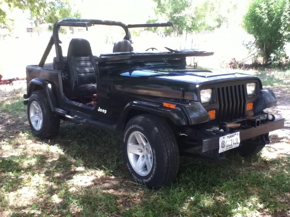

removing those got us to this. since i had no footman loop in the center of the windshield, i had to use a black ratchet strap from the door hinges, over hte windshield, through the hood footman loop, and back over the windshield.
we went for a test drive to the end of the street
and decided really quickly that safety glasses or goggles are a requirement with not windshield. after driving this way for the afternoon, i have decided to put the windshield back up tomorrow morning but am leaving the spreader bars out so i can keep the cj look
