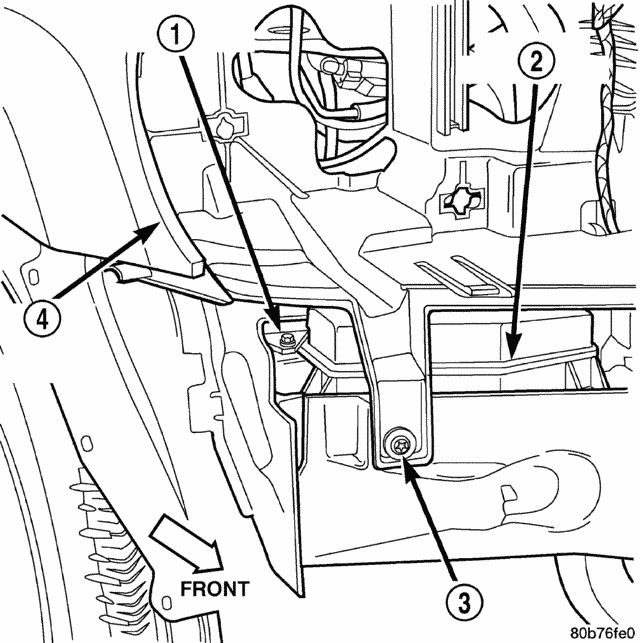

You will need a 3-4 inch hole saw. Remove the passenger side headlamp .The plastic base where the bottom of the headlamp sits, look for a small slit and see if you can locate the position of the radiator fan relay then drill the access hole to remove and replace the rad. fan relay. Make sure that the mounting surface is clean and use a small amount of dielectric grease on the back of the relay before mounting it back on the fender well.
1 is the location of the relay. To temporarily turn off the rad. fan. Pull off the 15A fuse in the junction block or the 40A fuse in the Power Distribution Center .

Thanks for the helpfull info Ihad to take the bumper cover and grill assy off ,then took the whole headlightand grill back up assy off easy only 8 screws and to push clips no holesawing of parts relay was right in the open. I put the fan connector back together to make fan run and disconnect it at relay fan stopped .took it out and wen`t to parts store .Replaced with new relay fan didn`t go back on relay did it`s job took jeep for drive to get hot fan kicked on and off life is all good again!!!8)8)8)8)
Glad that you got it fixed. That Hole saw service information is to make it easier to service the relay in the future instead of removing the facia and grill assembly appart.
