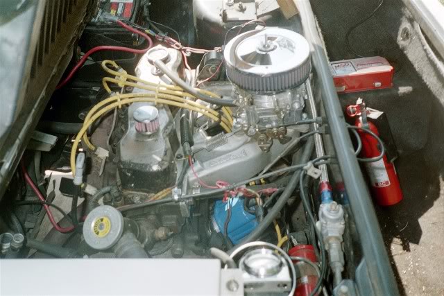

glenn what motor is that is it a iron duke 2.5 or what I have a few starters that may work if we find out what eng it is
every day i learn just a little more. i found the old dash board tag and it says "1969 dj5a" "L4T*3CID" *-is a number i can not work out.
thks for the responses so far but im unsure what a iron duke is. i think its a 2.5l 4 cyclinder. the fuel pump seems to be the same as a 134 military as it has the glass bowl on top of it. im thinking that this is a mutt and i guess if i carnt lift the engine number i will have to pull of the head cover to get the casting numbers.

That should read L4-153CID if it's a dookie. Who knows what changes the PO did. 5 slot grill is DJ. The other Jeeps are 7 slot.
lol maybe the t is a I so L4-153cid sounds like a winner. the grill isnt a dj (i went to the web sites that was surgested earlier in the post and the grill is a cj5 for sure...thanks for the link john). now im confussed alittle about the motor.....is it realy one side valve and one over head on the f-134 motor. the engine number near the water pump is T33486 which doesnt match any id numbers i could find on the net. i did find a site that says that dj5a was registered until 1972 but no records indicate that any was produced after 1968...hmmm...lol

The "Iron Duke" will have a flow through head, where the intake manifold will be on one side, the exhaust on the other. A f-134 will have the intake manifold built into the head and seperate exhaust, and the L-134 is a flathead. Since you mentioned it has a T90/Spicer 18, I'm willing to bet it's either an L134 of F134 . . .just a wild guess
the f134 was stock on many Kaiser jeeps from 50 until AMC bought Jeep in 71.
starter look like this this is for a 134 fhead and can be used for 12 volt just need to change selinoid to a 12 v
I got 2 of them
:) intake is built into the head and the exsaust manafold is attacked to the engine block on the other side so f-134 it is.
