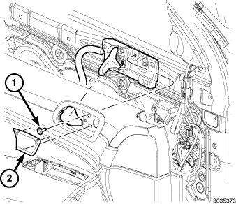

3.Using a suitable flat-bladed tool remove the trim cover (2) behind the inside handle and remove the screw (1).

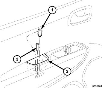

4.Remove the trim cover (1) from the armest pull cup (2) and remove the screw (3).

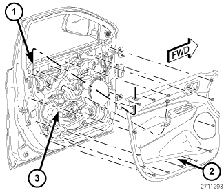

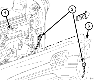

5.Using a trim stick C-4829A or equivalent, carefully pull the front door trim panel (2) away from the door far enough to release the plastic door trim panel retaining clips from the door.6.Lift the rear of the panel upward slightly to disengage the interior door latch lock link and knob (1) from the rear of the door panel and the inner belt seal.
7.Position the front door trim panel (3) far enough away from the door to access the door wire harness connectors (2).8.Disconnect the door wire harness.
