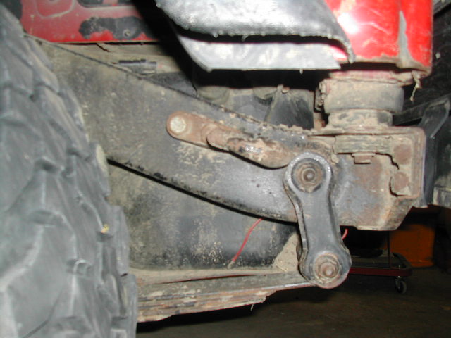

I mounted my rear hook on the outside of the driver's side frame rail, just in front of the shackle. Angle the hook down so the strap stays on and the hook is parallel to the frame. Two grade 8 bolts all the way through the other side of the frame, just don't drill into the fuel tank :shock:
Here ya go :D
