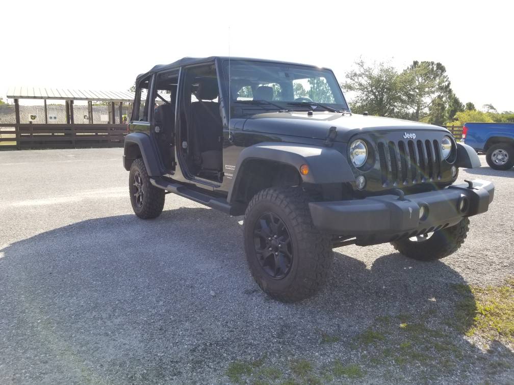

I went on a trail ride through the FL swamp yesterday and noticed a loud slow racheting sound while accelerating while 4hi and 4low were engaged, the sound went away when I went back to 2hi. I was under the jeep today and the diff levels are both where they are supposed to be and there was no obvious wear and tear or fluid spray that I could see anywhere. Im new to this so I could use some pointers to try and locate the source of the sound. 2015 jku sport with 3 inch bds lift and 32 inch tires. Any help greatly appreciated I am driving 300 miles later this week on a road trip and want to make sure nothing breaks on the way there.

Driveshaft feels tight turns about a quarter inch each direction as one unit with no play. Checked bearings without tearing into it, I jacked it up and "man handled" both front tires and there was no play, there are no visible cracks in any of the metal and all rubber boots appear intact I wanted to tackle this one myself for the experience but given that I still have a power train warranty for the next 40,000 I guess Ill leave it to the pros and make an appointment with the dealer
