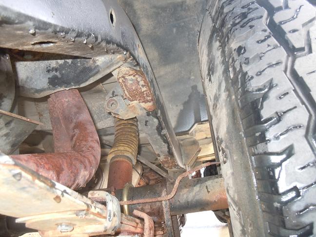

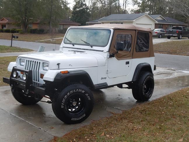

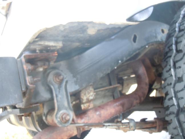

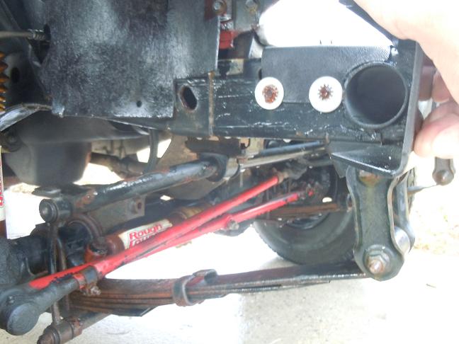

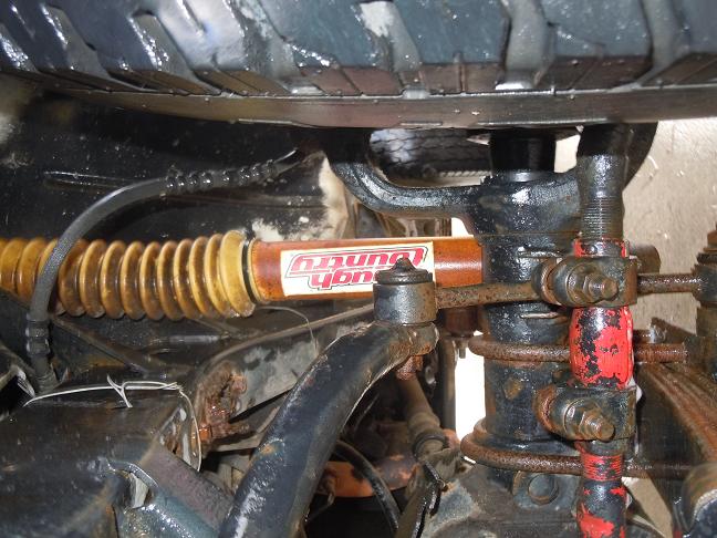

I have a 94 Yj that isin desperate need of shocks. besides the bushings being gone when i go over aspeed bump i get whip lash from how hard it hits. the problem is i don’t knowit has a suspension lift or not. it did have a 3 inch body lift when i firstgot it but i removed it. i have 31X10 tires on it. i attached some picturesthanks

Its hard to say, but 31" tires on a stock yj usually rub just a tad on the fender flare when wheeling, and the sway bar at full turn but not always. It has alot to do with the back spacing of the wheel.
Your springs don't look flat so that will help you. I would say if you do have a lift it,s not more than 2" in which case you use the stock shock length anyway.
What I noticed, you have no rear track bar so that's good, they're not needed on a YJ.
You have stock swaybar endlinks on the front, and from downward angle of the swaybar I'd say it's a 2.5" spring kit. The swaybar is nearly level with stock springs.
That front passenger side spring is bent just behind the shackle.
