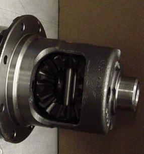

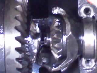

Im very hard on it and the only thing i broke was the diff but i think that was my doing somthing i should not have but yas fire roads and mud with just a little more but thats about it i have my two son's that ride with me. May26_0002.jpg

Its not realy a locker but limited slip but locks up good just dont play in the snow with it the cluches dont last $55 for new ones and having to instal them.. this is what im running now spicer track lock
