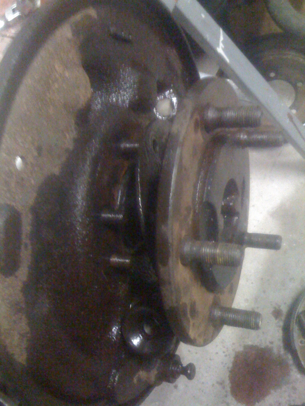

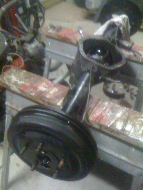

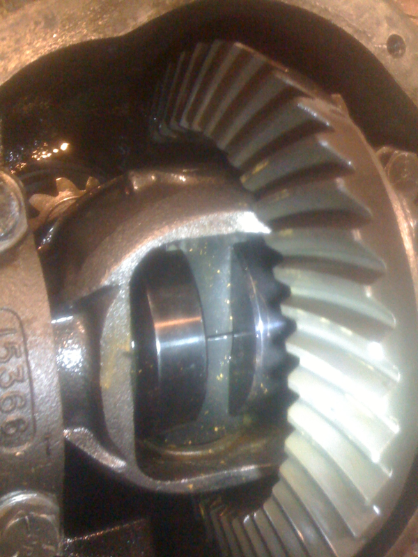

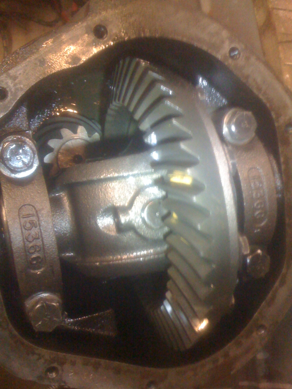

Have an old d44 out of cj 5. I'm trying to take apart to put an e locker in. Can u tell me how to get the axles out? I have pics of it. It has a full time locker n it now and I can not figurout how to get the shaves out?

Once you unbolt the flanges on the hub end of the axles they should slide out.
Take a chain and bolt the ends of it to two opposing lug nuts. Then take a heavy bar or four way lug wrench and wrap around the chain. Have someone stand on the housing and give the chain a real hard jerk, it may take a few jerks to pop the axle loose.
Strike it hard with a BFH on the end of the axle and it will bounce out. Be careful not to hit the lug nuts. Sometimes it takes a few hits.
Thank u guys I got it! And it's my neighbors jeep and he don't like the mini spool cause it's locked all time. The mini spool is brand new never been under a load. We baught this axle right after it was rebuilt so it's never been on the road. The spool is for sale if anyone wants it. Shoot me an offer and I will ship
