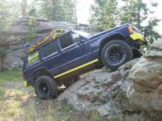

I had dura liner on my bumpers similar to the ones your looking at peeled of in less than a year . so I had them sand blasted to remove the remaining now they are painted with a industrial enamel that is baked on which seems to hold up a lot better
these have been painted about 6 years ago and still look good
hope this helps
