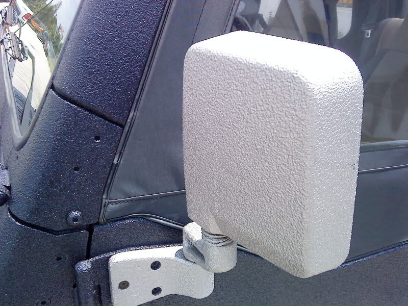

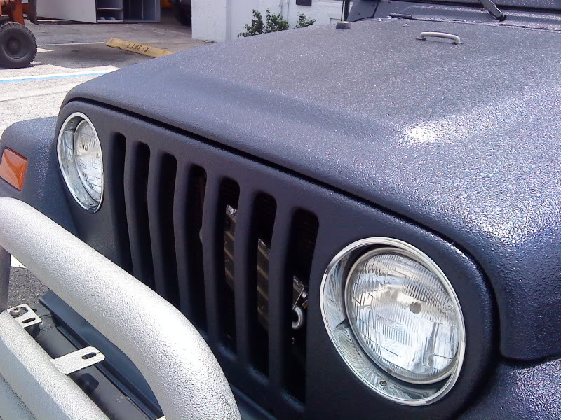

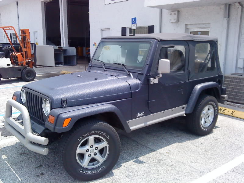

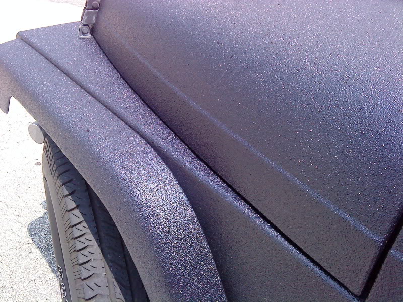

Here's a Line X'ed Jeep pic (not exactly my cup of tea, though):
I would think it would cost even less if you took it to them before it was mounted. It would cut down on labor for sure, and the back side would get a good coat.
That's what I did, and it does cost less (no laber to take off and mount later), and you do get a better coating. Both my Hanson front bumper and the rockers were COMPLETELY covered in the thing!

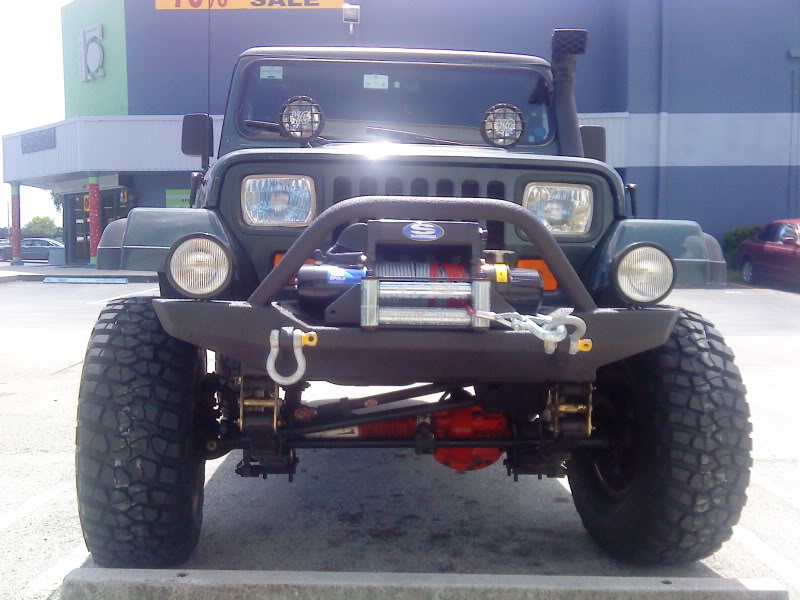

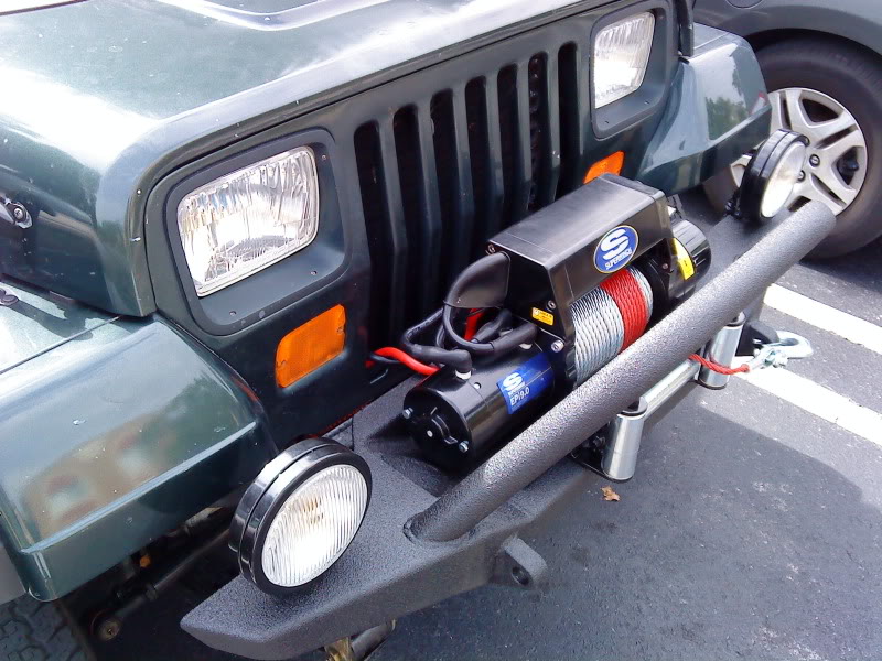

Here's a pic of the front of my Jeep:
I do wnat to warn you, though, that to get ALL the mud out of this surface, you need to pressure wash it, as because of the porosity, it is hard as nails to get it all out.
