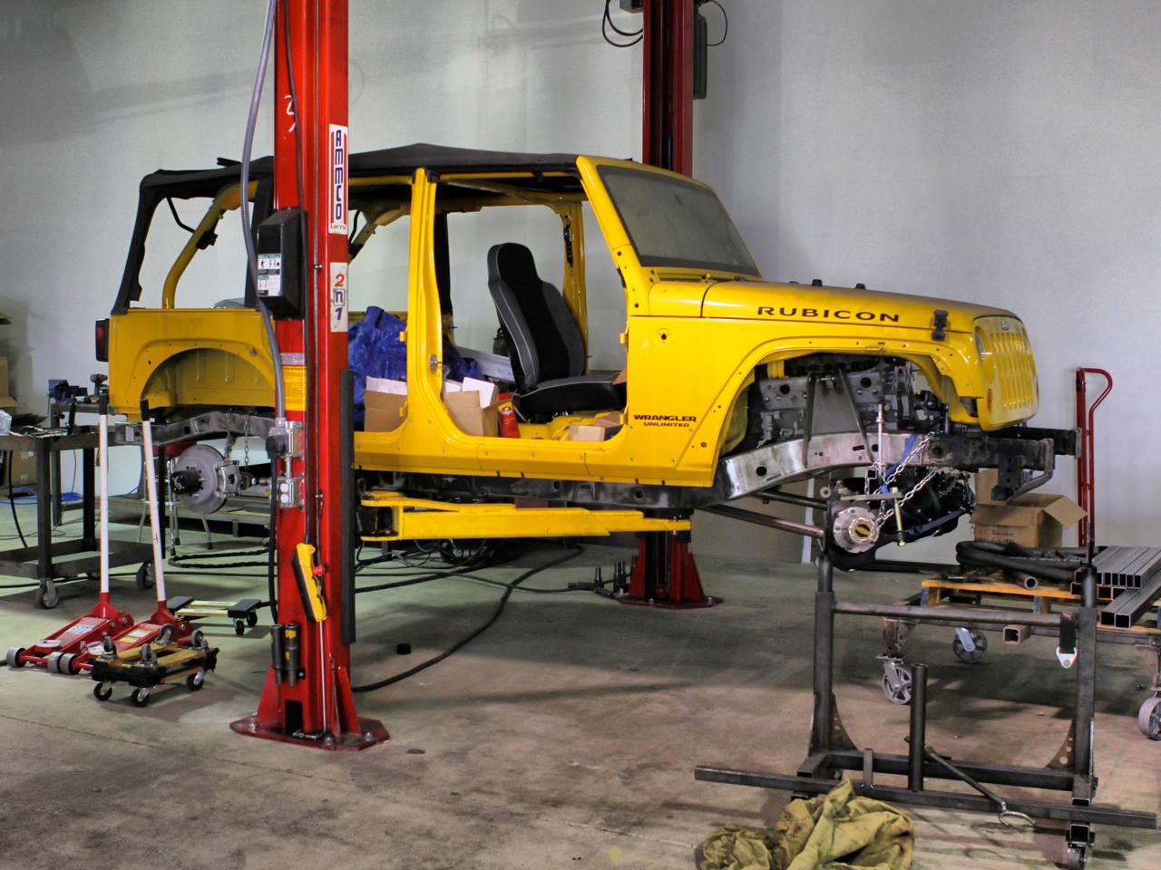

GenRight completely guts a Yellow JK for MAJOR overhaul!
GenRight Off Road

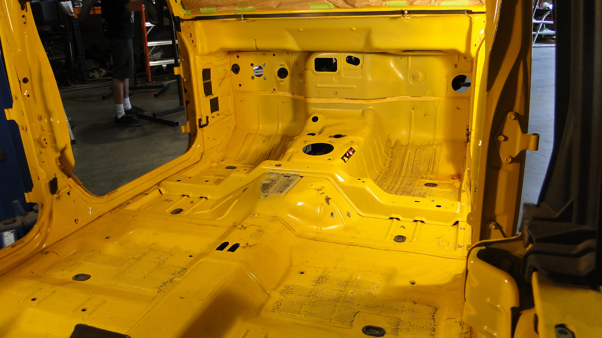

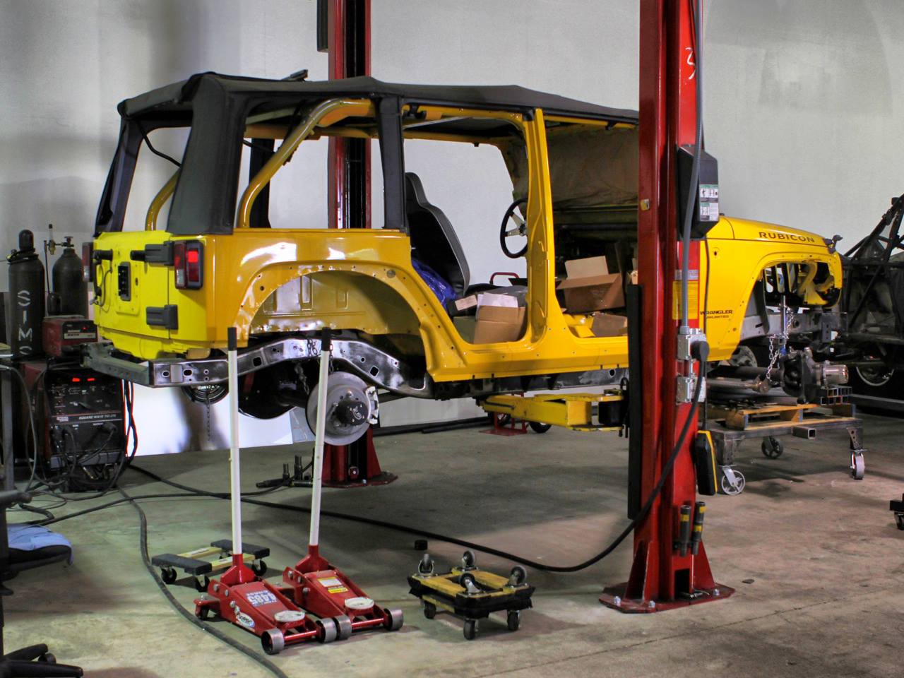

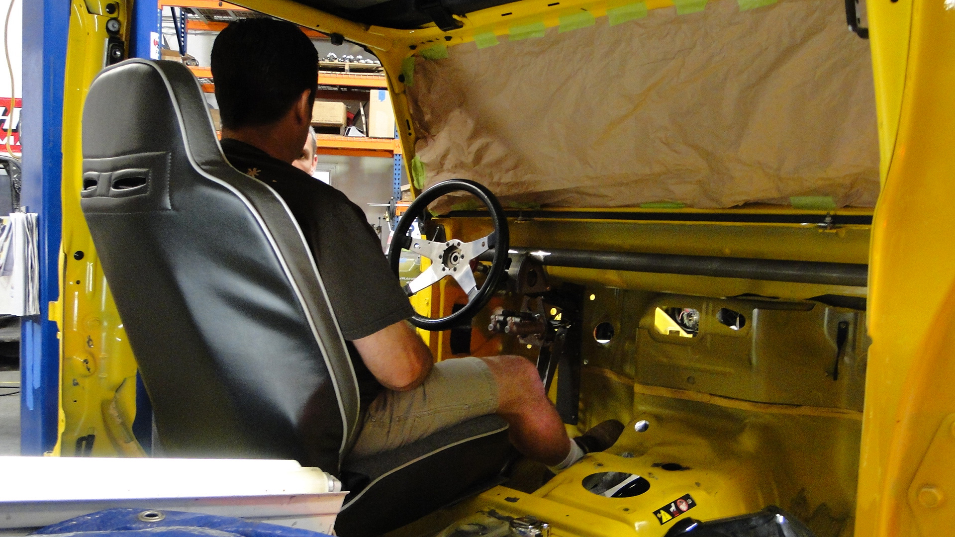

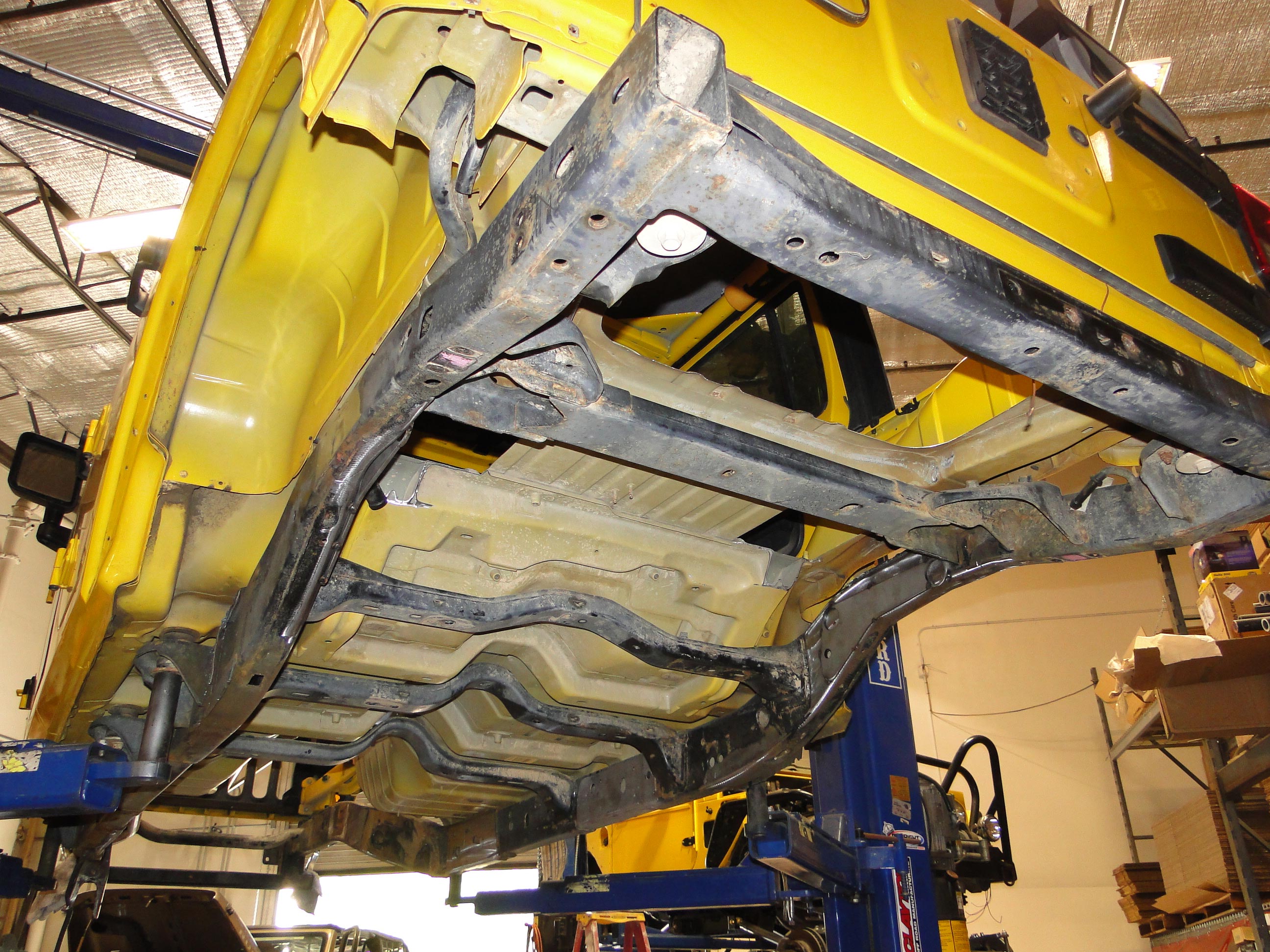

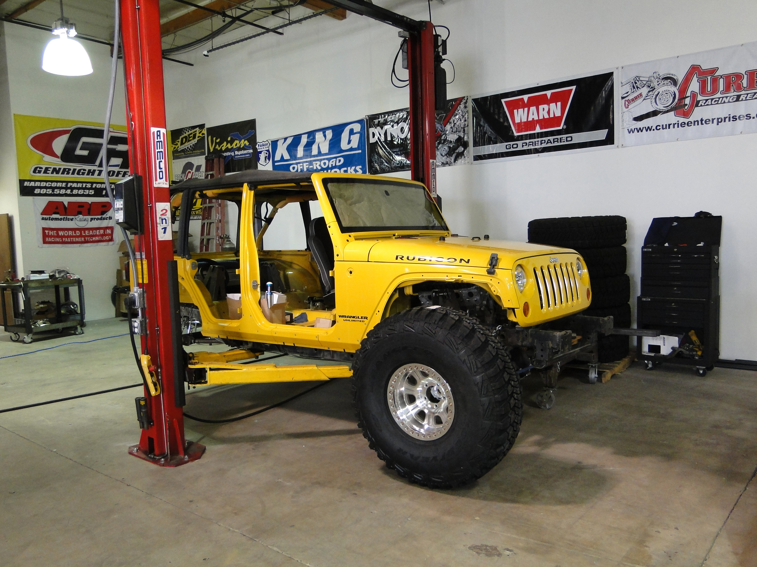

GenRight is setting out to build the best JK the off-road industry has ever seen!!
The team completely gutted a 2008 Jeep JK Rubicon!!!
- No dash!
- No engine!
- No wiring!
- Nothing factory of any kind (except for the tub and frame)!
What's the plan?!
- Hand built & soup'd up 625HP Chevy LS3 V* engine with a TCI built 4L80 transmission
- Atlas transfer case
- Currie Rock Jock 60 axles
- Our GenRight Elite double triangulated 4 Link suspension system with King 2.5" IBP shocks
- 40" Goodyear MT/R' on Race line beadlock wheels
It will have a completely custom built interior:
- Aluminum dash
- RacePak digital readout
- 8" Lowrance GPS
- Race radio, etc.
- (4) PRP bucket seats
- A custom GenRight roll cage
- and much more.....
A normal Chevrolet "performance" LS3 is 500hp. This engine has the new Wiseco 416ci forged crank and piston Stroker kit, big throaty Comp Cam and Stage 3 L92 heads for 600+HP (same as Tony's old KOH race car engine). It will have a custom 3" stainless exhaust for good flow, and low slung on 40's!!!

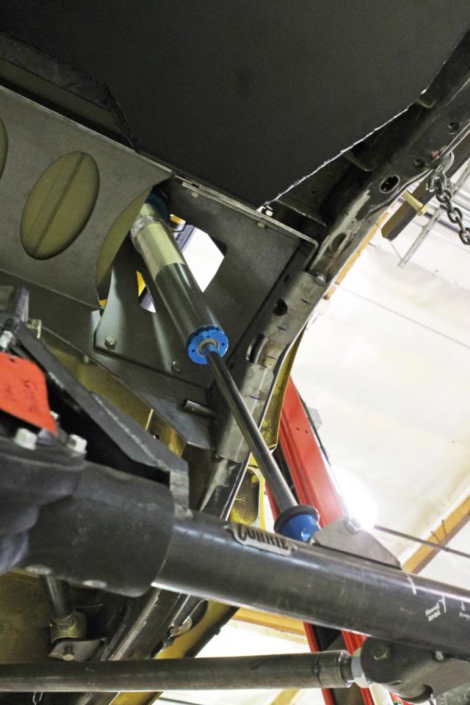

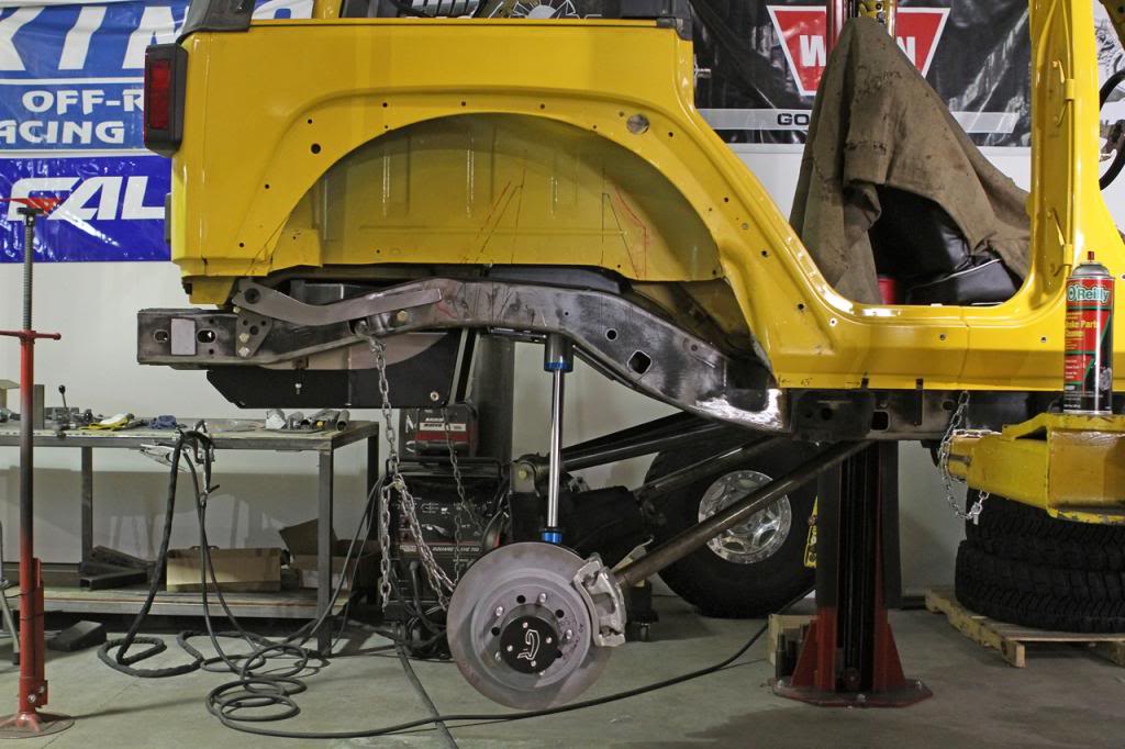

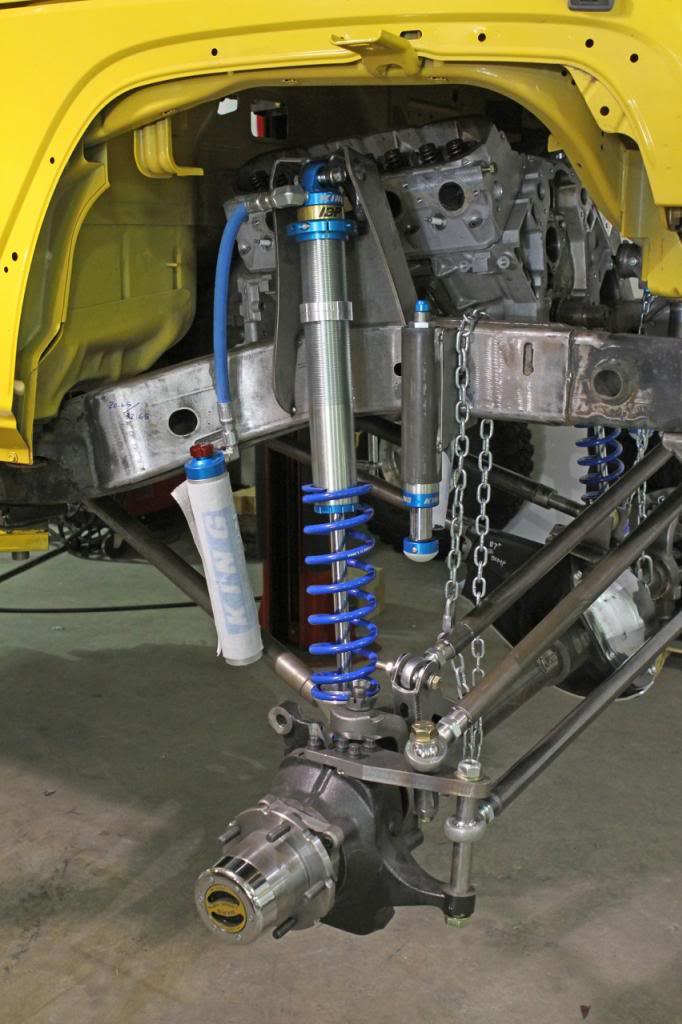

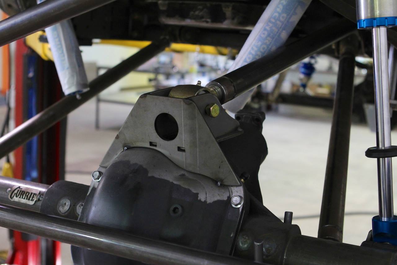

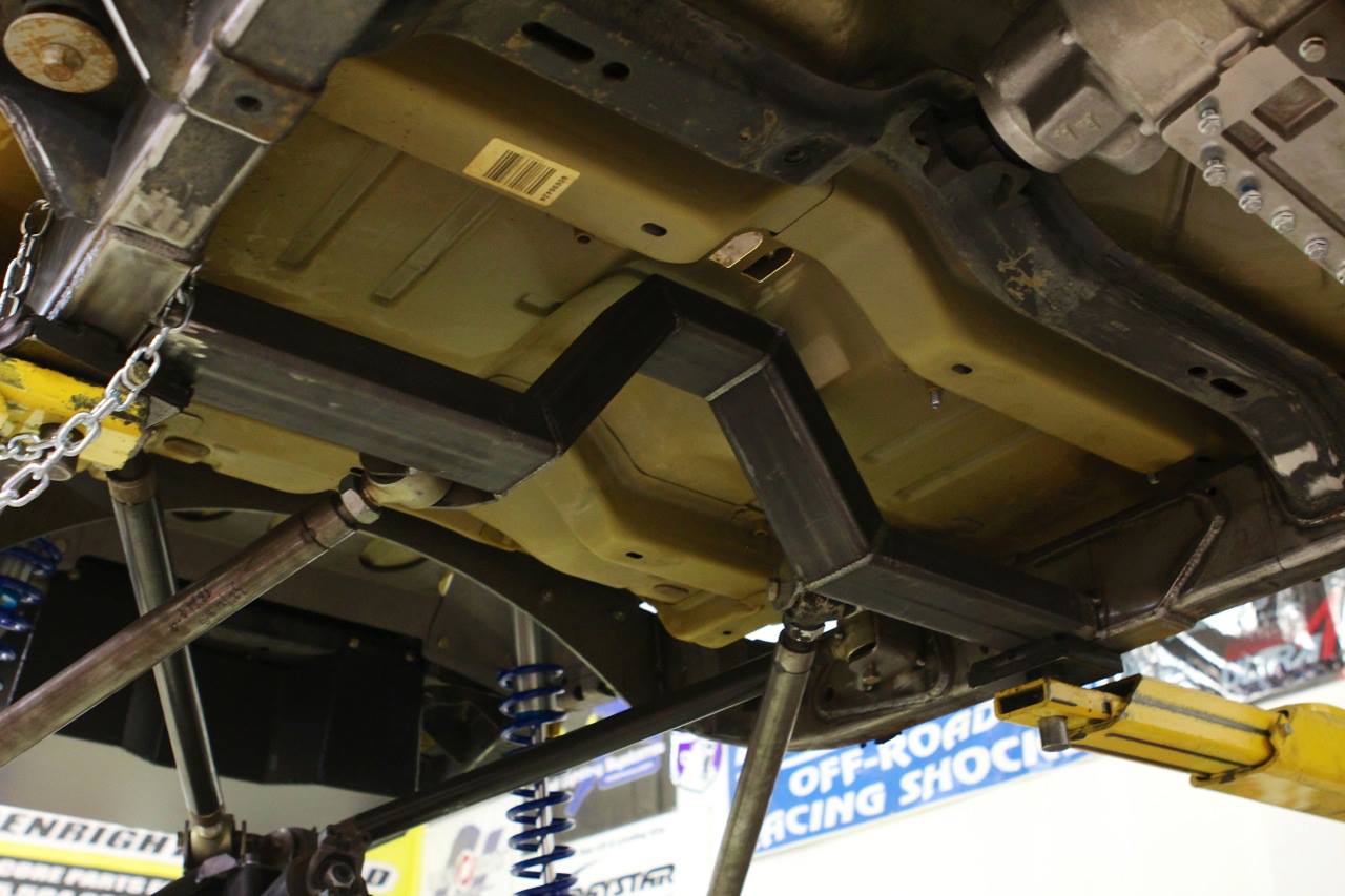

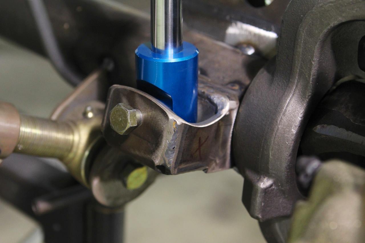

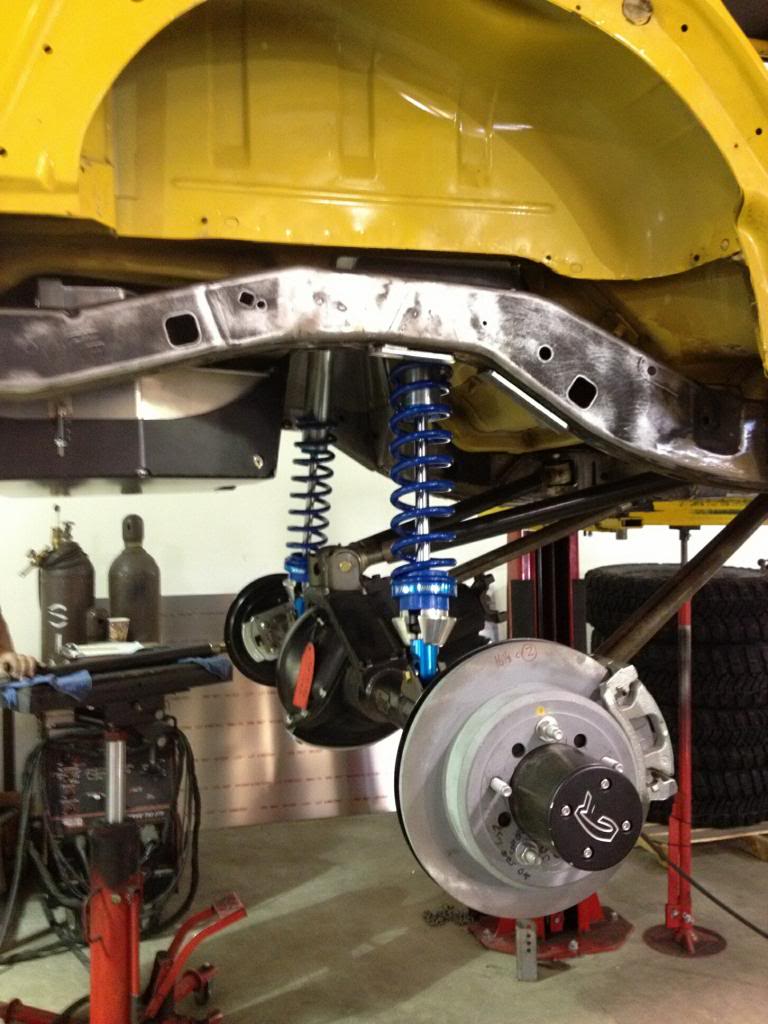

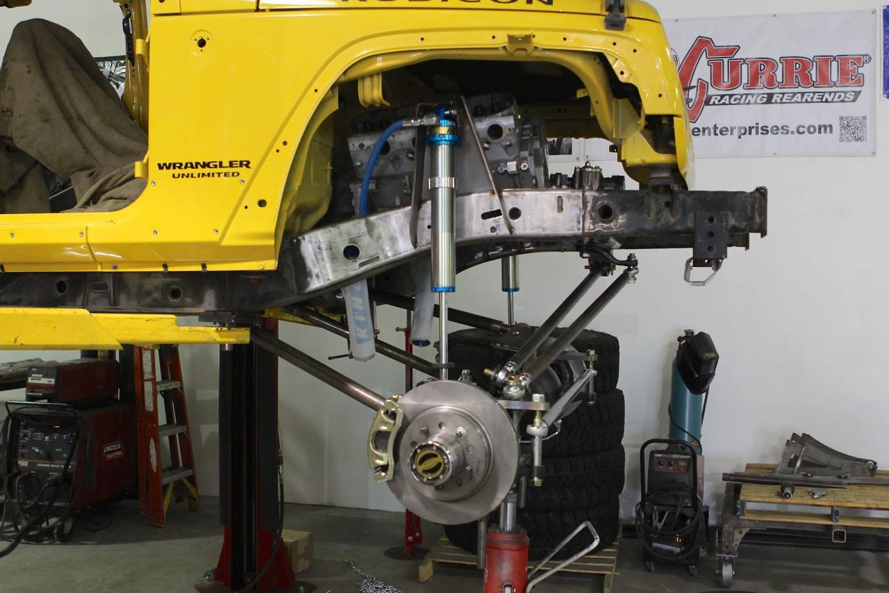

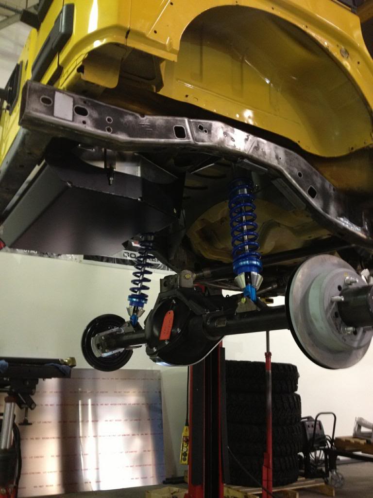

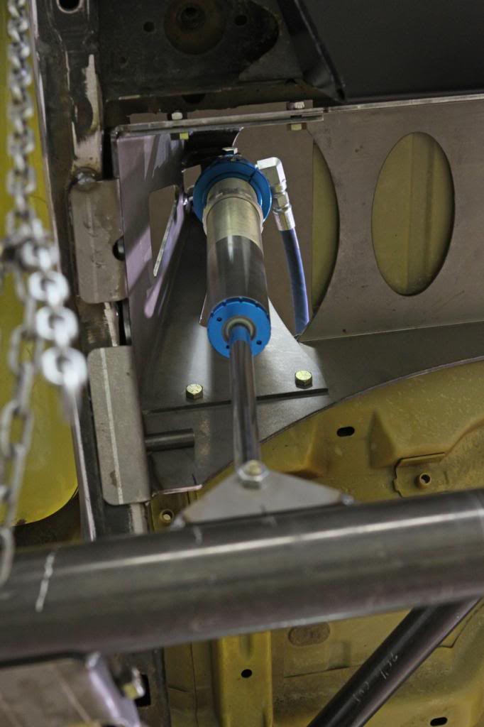

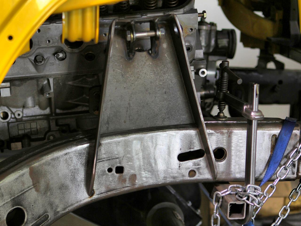

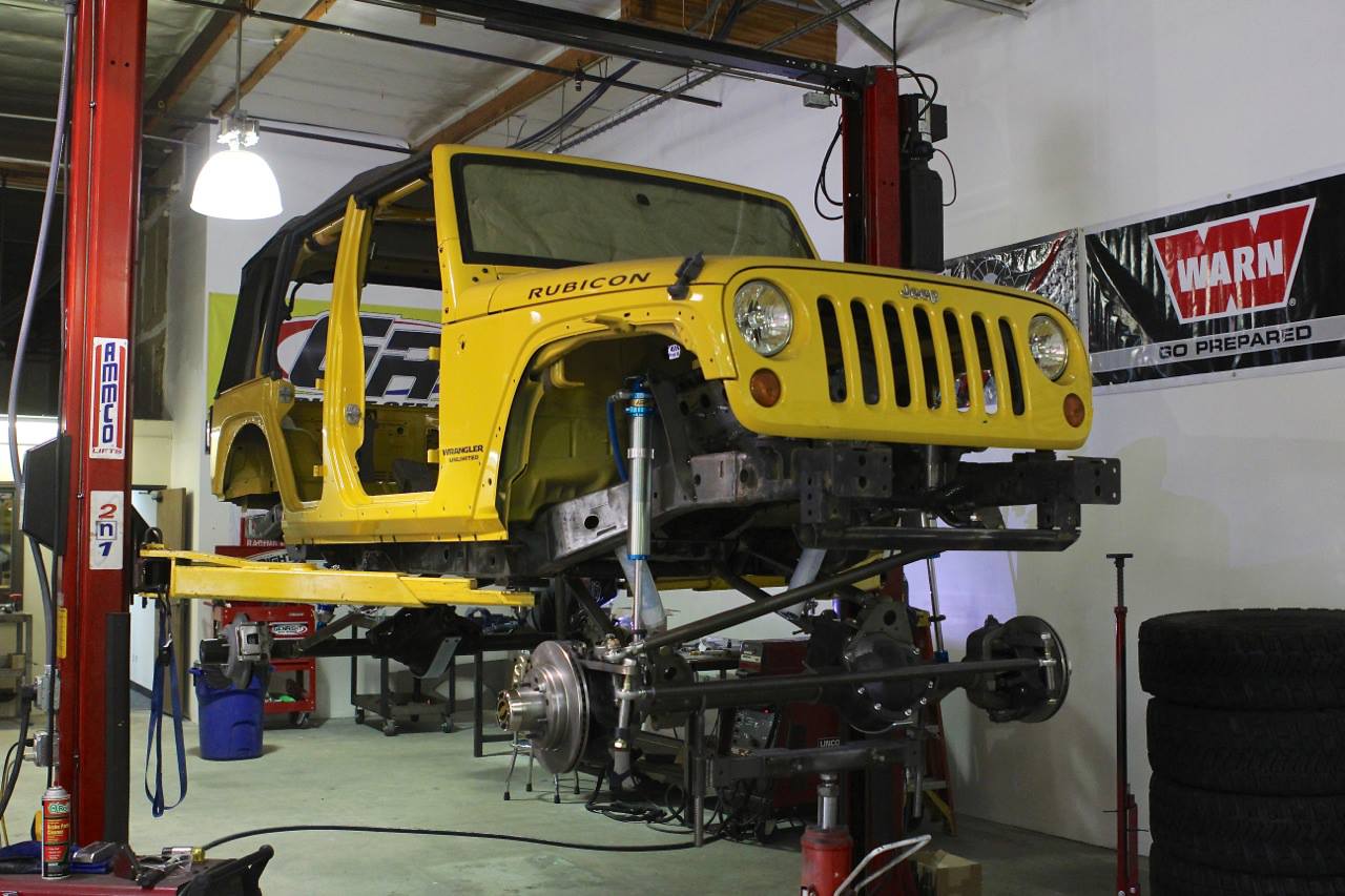

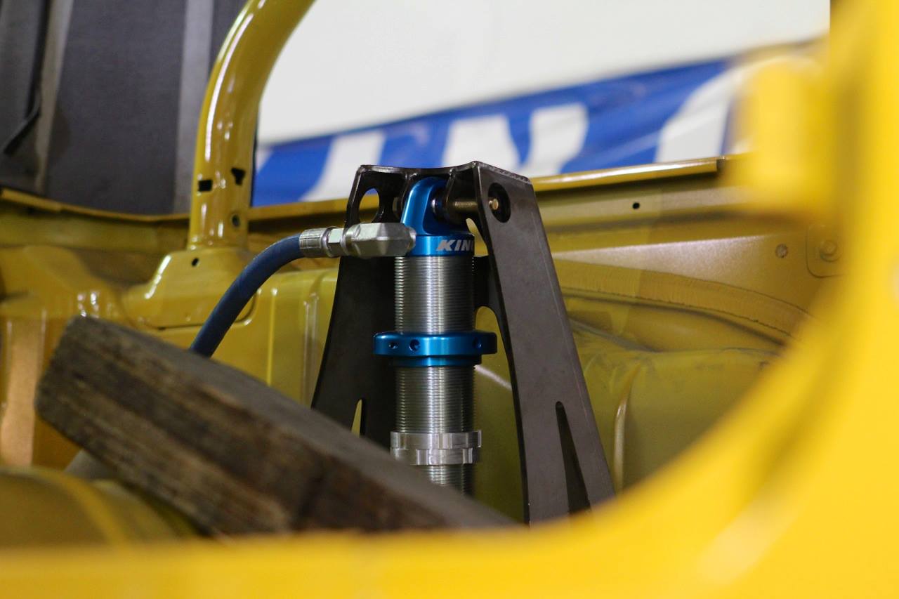

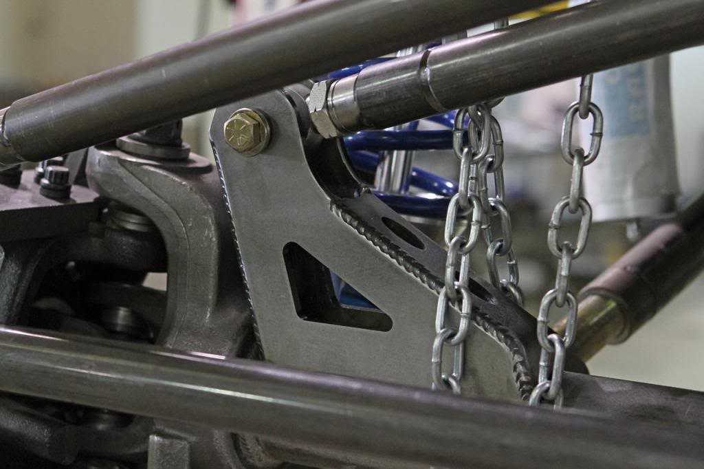

Axles are in place, rear suspension is almost done, front suspension is in the works, JK gas tank and skid are in place, and the "test fit engine is out with the overhauled engine in place! Here are a couple suspension teaser pictures:
And the build continues! :D
