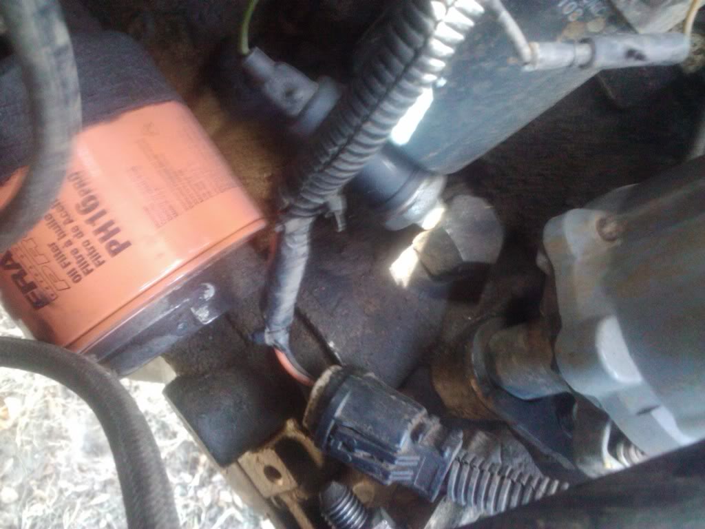

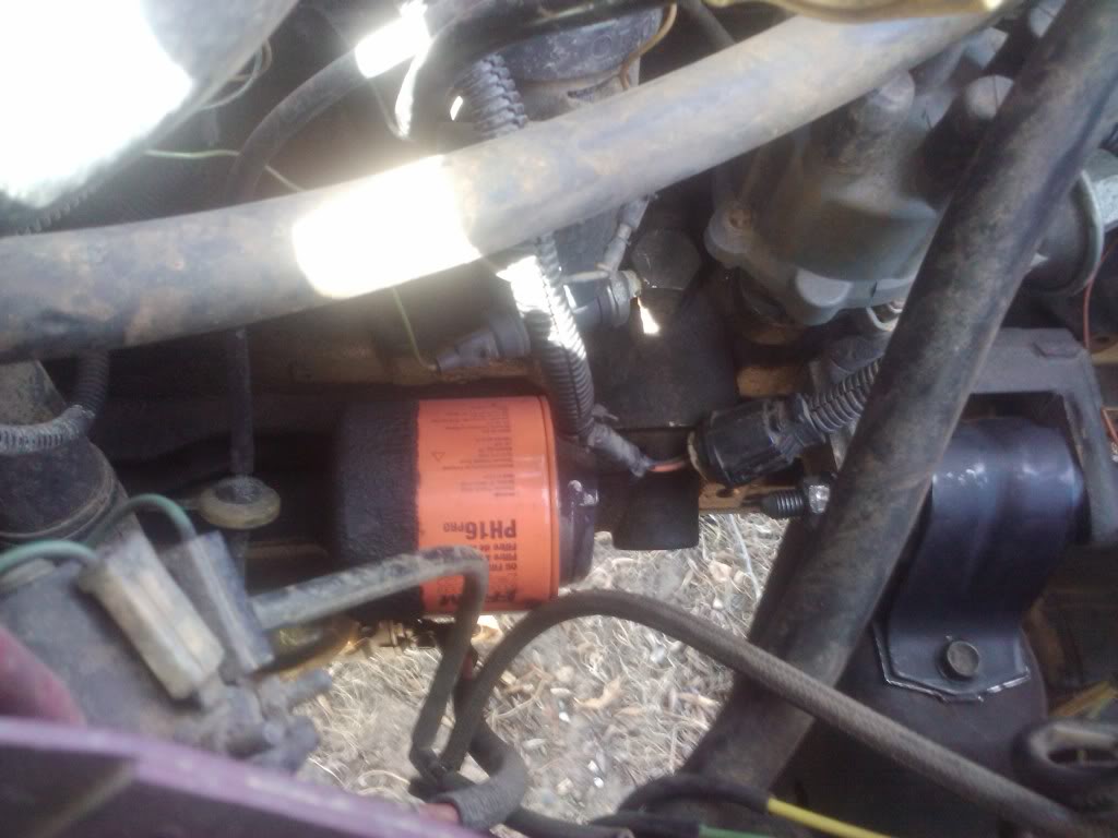

screw it, let me go look and take a pic for you. i cannot be so lazy to not do that
ok, turns out i still have the adapter on so it must've been another motor i took it off of
Thats exactly what mine look like, except you have a lot more room to work. My frame is a couple inches off the 90* so it will be interesting to see how easy it is to fix.
If i remember correctly i modified a 9/16 alllen by cutting it to size and used a wrench to turn the allen piece on the adaptor. There's 2 o-rings on that adapter.
