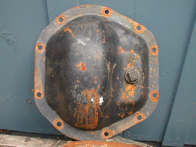

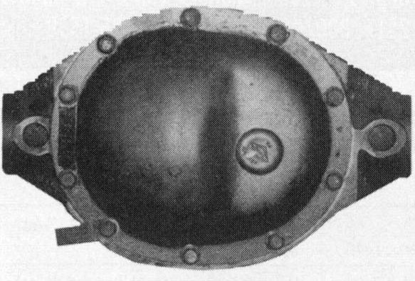

Here's a dana44 diff cover, below it is the dana35:
ok,Thanks for the help.It is a Dana 35.Picked one up,cheap.Found out the bearings were shot,replaced them,got it all set back up.Now...The thickest ridge on the dif,bearing cap does go towards the dif. correct? Because,I thought I had it layed out the way it came out but the bolts do not seem to want to start unless the caps are on with the thin rib towards the diff. Then they go right in. Strange...It LOOKS better with the thin rib in.With the thick rib in,the offset in the holes in the right side cap make the cap set off of the pedetal in the case,to the inside.And it looks to set over the shim better with the thin rib in also. There is also a wear mark from the shim that makes it look like they go that way,but it looks to have been apart before,so It may not have been right when I took it apart...............Thanks
