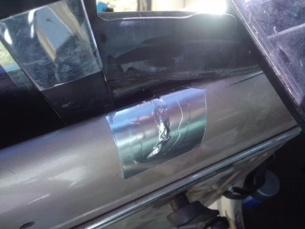

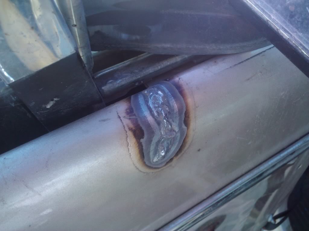

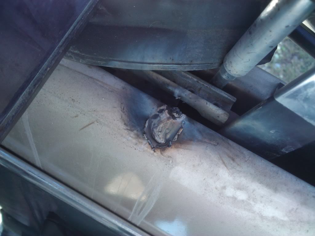

Either plan works. Check to make sure the sheet metal isn't torn at the point where the pop out window and the regular window meet, though. They are always torn right there so do it now and you can just weld it up while the doors are being worked for the screw holes. It's super easy and then you won't have anymore trouble with it.
These are my wife's 93 Sahara doors. That's the welds I did to fix where hers where torn.
And I only had silver paint in the garage so have proper supplies before you weld, ha ha ha
