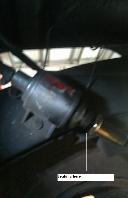

OK, Hopefully I am getting somewhere.:D Gentlemen take a look at the pic of the electric auxillary fuel pump, (not used, and will be removed tomorrow after a trip to get new fuel line). It is leaking/seeping. I have not driven the Jeep since Sat. The spot on the garage floor was approximately 2" sq. Would I be safe assuming if it can leak then it can also suck air into the lines possibly causing this problem?

It's never safe to have a fuel leak. All it's gonna take is a small spark then off it goes in a fire ball. Hey! That'll be cool, ghost rider in a jeep, lol. Anywho, it would be safe to assume that the leak has to do with the issue your having with the jeep. I'd say fix it then retest .
If the "vapor line" is what the tank vents off of ,I could see where kinking it or plugging it would cause the engine to stall. Without a vent eventually fuel will stop flowing and I would imagine it would be pretty hard on the fuel pump. I would try unkinking the vapor line to see if that fixes it. It's simple and don't cost anything. If it works I would then look for a vapor canister. But that's just my opinion. Good luck.
