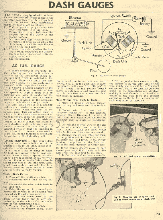

Hi my jeep is a 1985.I just bought it and I do have a lot of things that need to be repaired and straightened out. I think im in the right place. Thanks Scott.

This should be helpful. This is pretty close.
The funny thing with Jeep gauges, is the engine temperature, and gas are inner connected.
The gas gauge regulates the power feeding to the temp. gauge.
The second image is an old article I found that might give you some ideas.
My '78 CJ5 gave me a fit. I hope yours goes better.
Finding good quality gauges is hard to do.
Thank you Tison I am going to see if I can copy that info. The young fella I got the jeep from did the best he could with the tools and resources he had. I have the whole unit out right now and I see what you mean by the fuel and temp gauge being connected. I put a test light to it but I have no power. Wiring is the least thing I like to do. Thanks again Scott.
