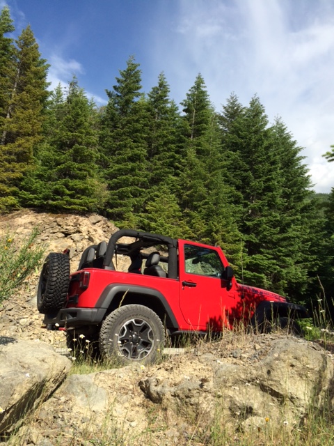

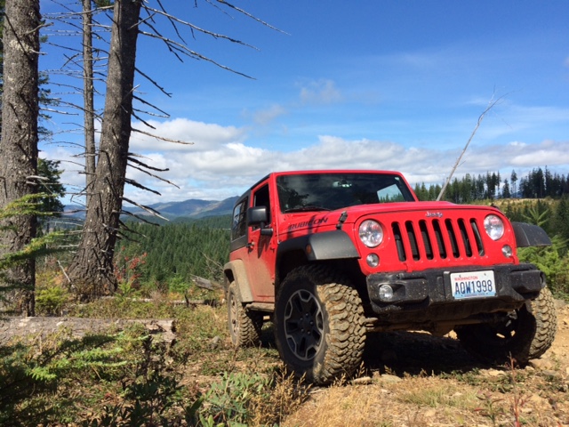

Fixed my problem ... traded on a Rubicon X a little over a year ago ... (don't get on here much lately) ... a couple of fairly recent photos attached ...
R/
'Chop

Nice looking Rubi. Glad you didn't go with the '10, you wouldn't have liked the lack of power in the 3.8L engine.
