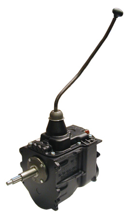

RIght on Saddle Tramp! That's good news. I'm intending to go through this trans. provided it's not missing any parts when I go look at it today. My '78 CJ5 'Betty' is a complete runner with a good running T150 and the bellhousing. This is not a breakdown repair, moreover it's just something I'm going to put on the bench and set up for when I can get it all together, trans. drivelines, and transfer case. If anyone has any further resources though I'd be right grateful. :) This's a pic from the ad;
It appears to be a short shaft (I'm hoping for 6.5 inches on the input side)
