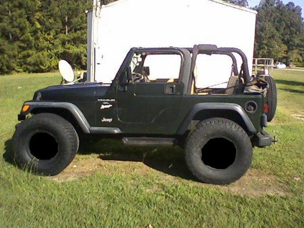

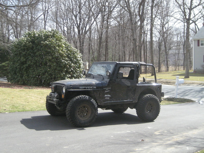

definatly... For what ever reason, people seam to think you need to have a huge amount of lift on your jeep to fit a tire.. I have a 4" lift (settled to 3.5 probably) on my YJ and I just put on a set of 37's and they fit just fine. ya, it's a little cut here or there, but look in my sig, it's not horrible looking. I will find the pic of my friends TJ, zero lift and 35's.. I have posted it here a couple hundred times.
