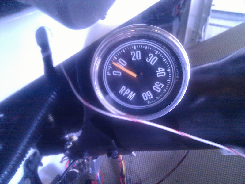

Hello. I have a Jeep cj7 1986 with 258cid. I have done frame off restoration on it and i have issue with the factory tachometer.
I bought the cj7 wire harnes set (#10110) from Painless. And i am done installing it and everything works just fine beside the factory tachometer.
The tach that i have is a Jeep stock tach from the factory setup.

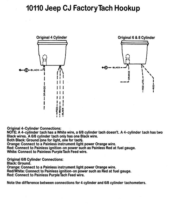

Originaly it is connected in series of a red wire with white traces under the dash. But the painless wiresystem suggest that I should connect to the purple tach wire and the red wire on the fuel gauge. I know that the black and orange are for the bulp, and that works fine. Look at the attachement to see how Painless suggest connecting the tach.

Take a look at the Painless wire harnes manual at page 18-19. The schematic says that the purple wire marked #TACH should be connected to the negative side of the coil.

But as you are saying, the tach cable should be connected to he POSITIVE side and not the NEGATIVE. This is what confusing me, since the factory tach is connected at the POSITIVE red/white wire. I think with at an aftermarked tach this will work, but i want to use my stock one.

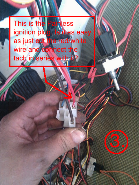

The Bypass can damage my coil when i thinking about it. I have a ballastresistor on my setup to prevent the coil for getting +12V. If i do the bypass i will override that and the coil will get +12V.
Another guy at another Jeep forum told me to connect it in series with the red/white ignition wire . I will try that to see if it works.

UPDATE: Never mind, i got it working. I connected it in series with the red/white wire on the ignition.
