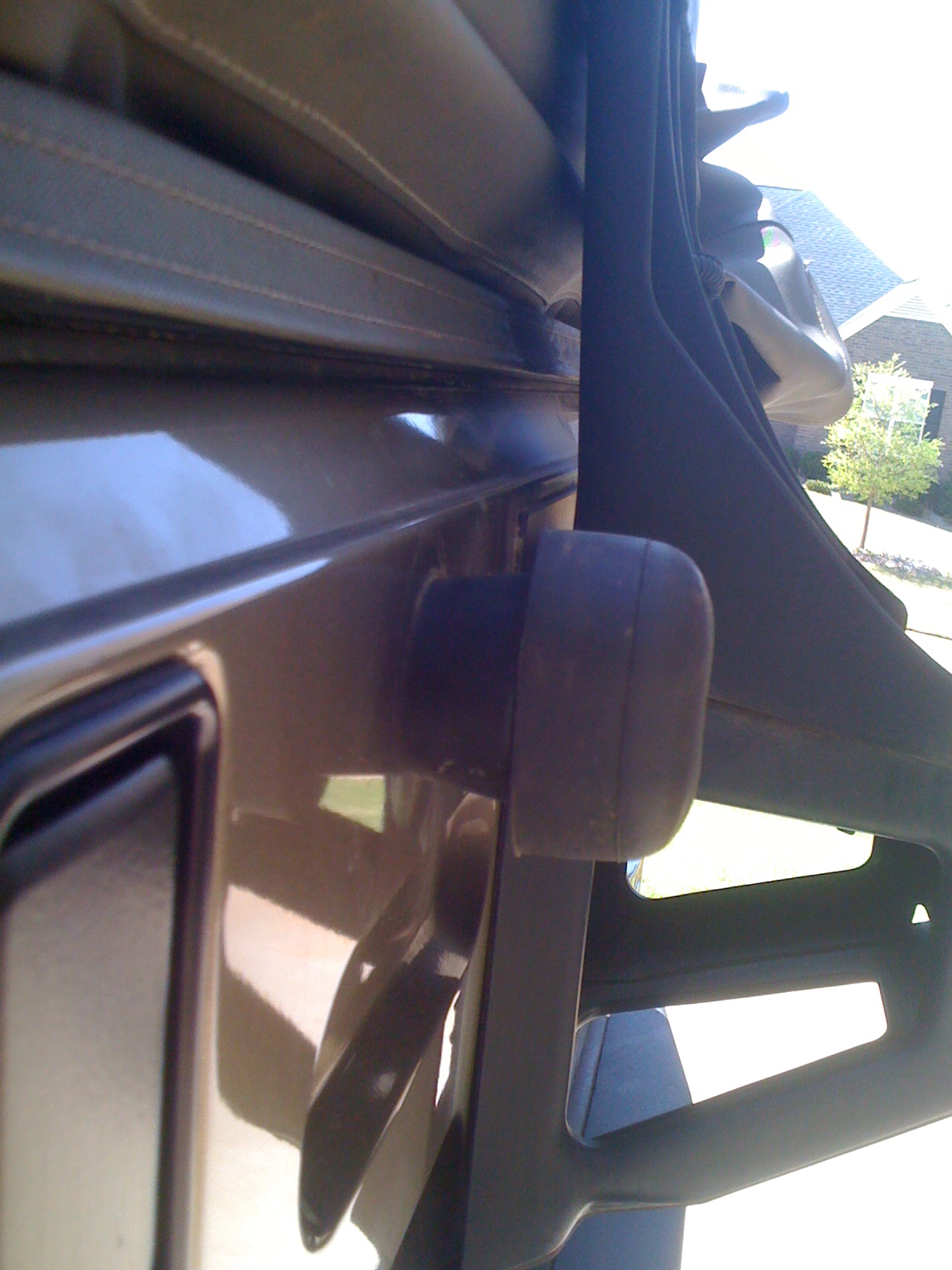

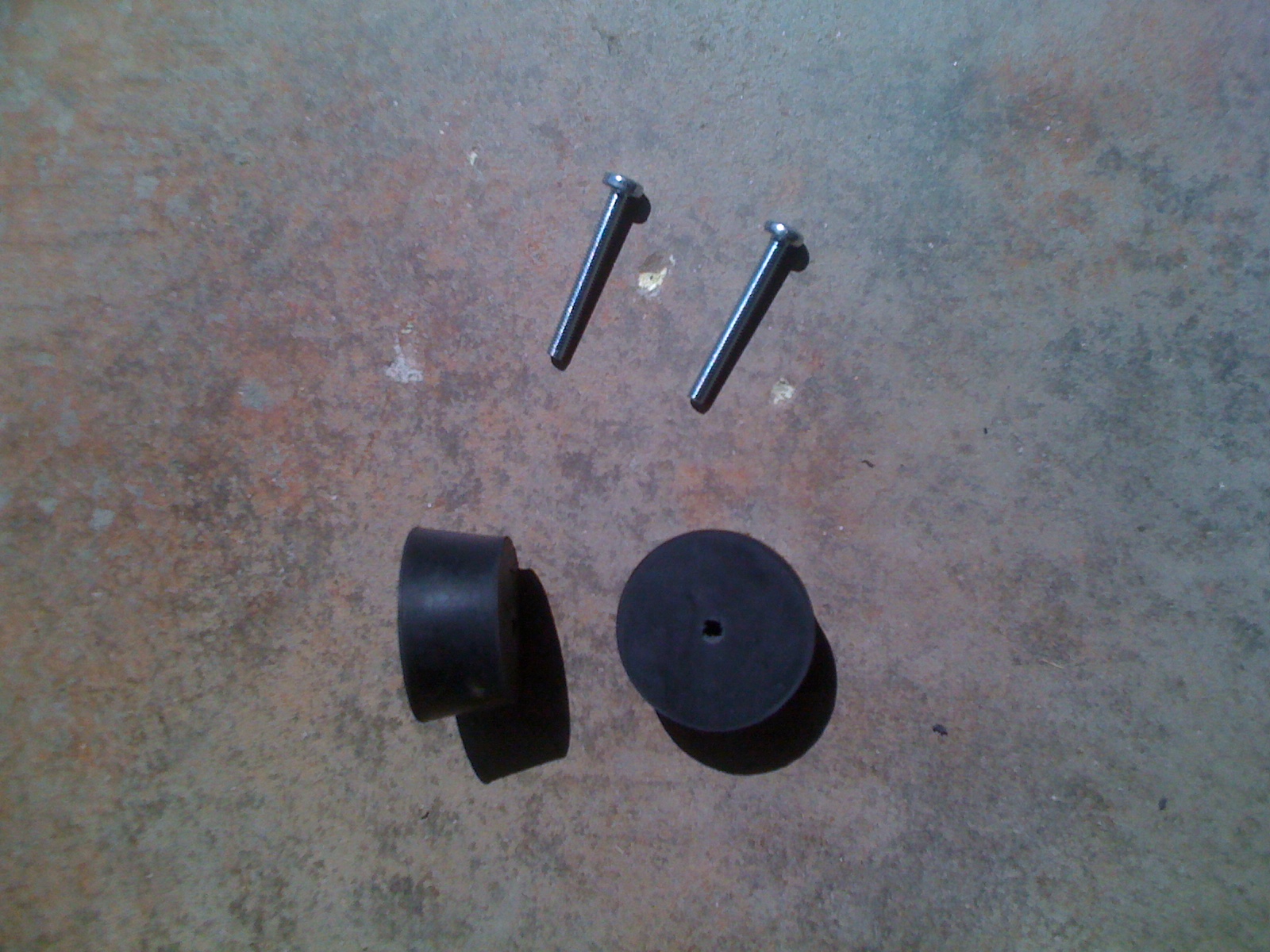

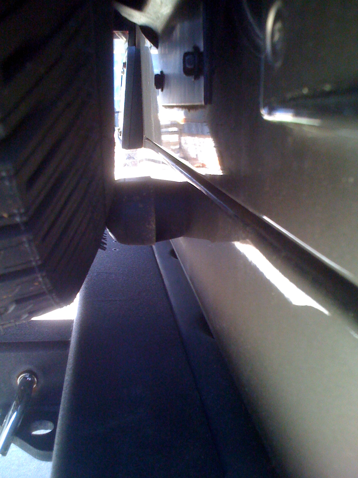

Here's what I ended up doing:
Bought 2" X 1.5" rubber stoppers from the hardware store (3), and longer screws (2") with a matching thread pattern. Drilled holes through the stoppers, then mounted the stock rubber on top of them. Parts were around $12. Quick, cheap, and easy. See photos attached.

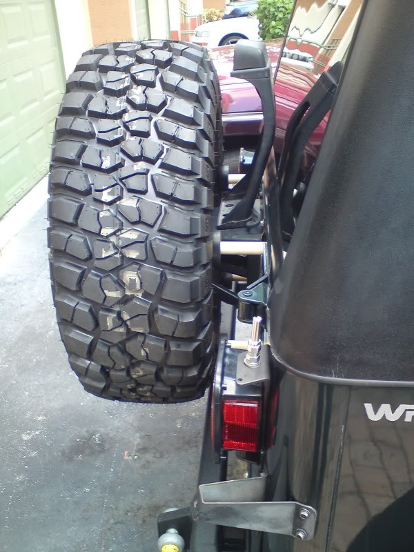

I used ABS plastic on mine, as I needed to extend quite a bit (had to put in a spacer to clear the rear bumper). Here's how it looks like (ABS also comes in black, but I could not find it):
Wow...you did have to extend quite a ways. Would've take 2 or 3 stoppers to make that distance.
If you aren't happy with the PVC color, can't you spray paint them black? Krylon makes a plastic paint.
Yeah, I COULD paint them... If I were not so lazy, at least! I was going to hit them with the rattle can liner black, but never did get around to it. Now I'm kind of used to them.
