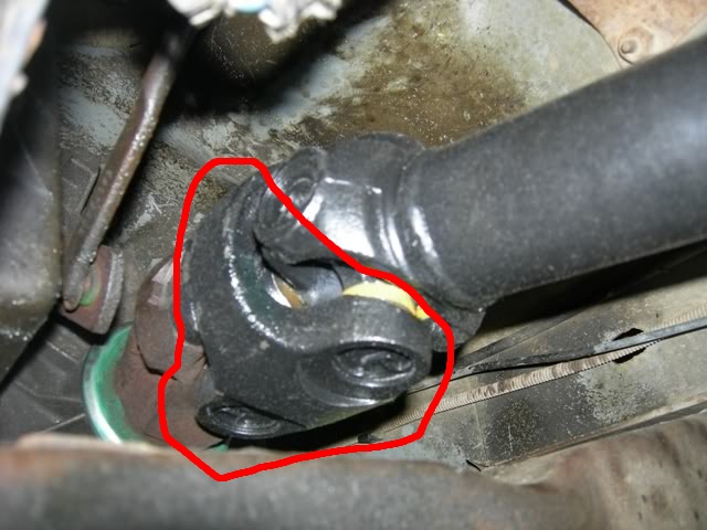

Hi all, I am going to lift my jeep from 3" to 4" and I am wandering if I use a yoke from a front axle to extend the rear so I can move the rear axle more center??
The pics should show what I mean.
Thanks for any help.

I don't understand what you mean by moving the axle more 'center', unless you're wanting to raise the yoke on the rear axle so it is more inline with the driveshaft and transfer case output. You can only do this if you install a slipyoke eliminator (SYE) on the transfer case so the rear output is a fixed CV type yoke, same as the front output.
A SYE is only offered for a few select transfer cases, 231 and 242 to be exact, so check the model number of your transfer case found on the round tag on the rear cover.

On the transfer case I don't have a slipyoke I don't even have a slipyoke on the front ether, the 5.9 came with full CV's, my t-case is a NV249, or was it a NP any way. The yoke for the front, which is circled in red in the pic, it's by the t-case will it work on the rear to lengthen it? Did the question sound bedder? I was never good at trying to explain something. :redface:
When I looked at the rear shaft after the 3" lift was put on it looked like it was puled out about 2" or so for the lift to work, so I'm not sure how much length I need since I don't have a slipyoke. What would be the best way to figure out how much length I need?

Your front driveshaft uses a double-cardan joint at the transfer case, commonly (and improperly) known as a CV joint.
The CV joint is not interchangeable with the slipyoke on the rear output. Your best bet is to have the stock rear shaft professionally lengthened at a driveshaft shop.
Ok it is a slipyoke and it is stock. A double-cardan that's what's it called ok.
