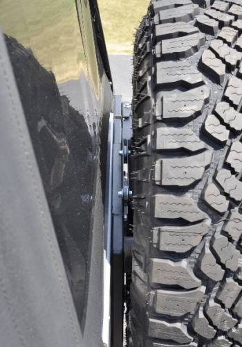

Does anyone here own, or have you seen the Exogate spare tire carrier from Gr8tops? It looks like exactly what I want - a low profile tire carrier that looks stock, but can hold my 33" spare.
I've only heard good things about it, and will probably be picking one up.
TJ/LJ Exogate™ Tailgate Kit

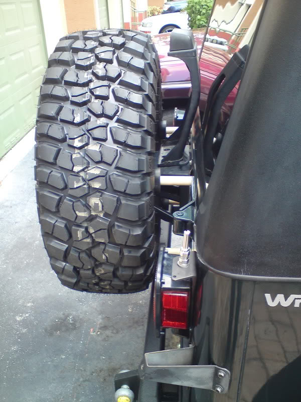

Dont know about the exocage, but I have had my 33" BFG MT KM2 on my tailgate for a bit over 3 years without issues. All you need to do is to extend the bumpstops on your tailgate to keep the tire from bobbing around and you can carry your 33 on your stock carrier. A lot cheaper. Also, keep in mind the TJ hinges are a bit stronger than the YJ, so you should be even better than I am (and I not only constantly wheel my rig, but I also drive in Costa Rica, so not the smooth highways you are used to!).

I've got the same spare, and have extended the bumpstops as well. It's been on there a year, and it seems to be holding up well, but I can still hear it rattle when I hit bumps on the interstate. There is a small amount of play in it as well. It would probably be fine for a couple more years, but I think that this may be a better solution.
I've made it a bit worse by adding a teraflex tire spacer that pushes the tire farther away from the body, making the rattle even worse.
With the tailgate slightly open you can see the weight of the tire twisting the tailgate in this photo.

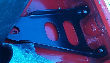

I've read that it also comes with a roll bar tie-in. This mounts inside of the Jeep and connects the upper hinge to the roll bar
