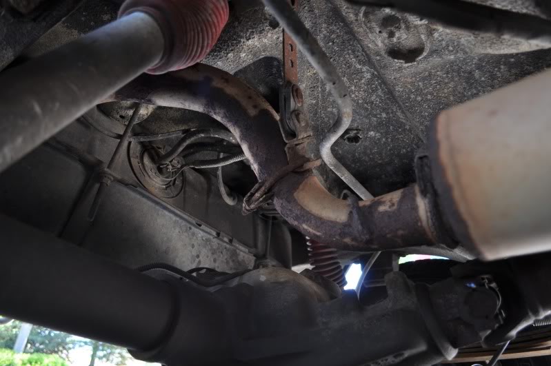

Here is the bracket connecting the upper exhaust system to the cat.

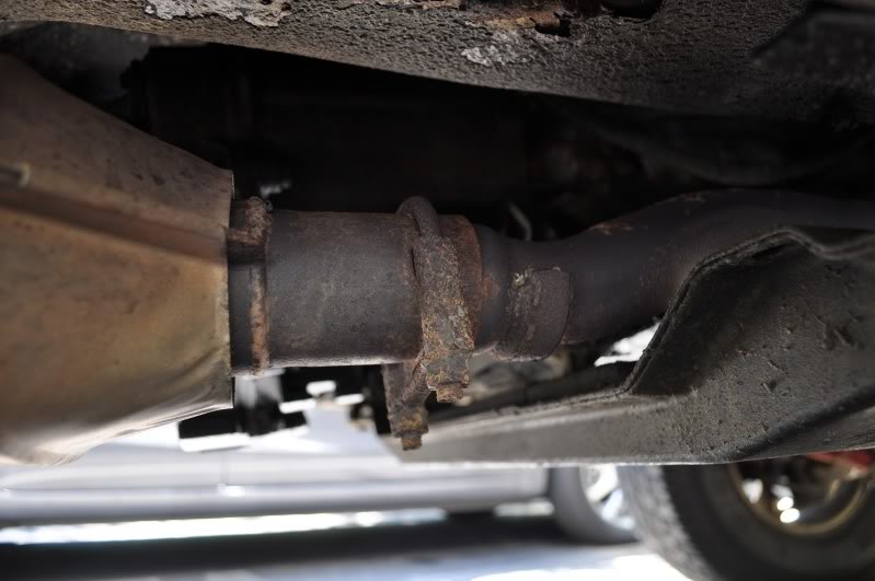

Picture of a hanging bracket that I will replace.

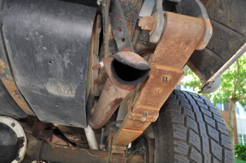

Tail pipe, seen some better days... You can see a makeshift bracket that I put together about a year ago, before the damn thing was just about dragging.
Everybody needs a grinder. When I got mine I bought cut-off wheels for it and rarely ever use my sawz-all anymore (although the sawz-all is better on exhaust pipe). I just replaced my exhaust and sold the converter for what the new muffler cost. You should be able to get 30.00-40.00 dollars for that old cat. Also, I prefer the tail pipe exiting out the side, behind the spring hanger so it won't bury in the dirt while backing into/up a bank etc.
I usually put a 3/4" block of wood under the exhaust where it goes over the transmission cross member. If you don't leave yourself enough clearance it will bang on the cross member when your done. I tighten up all the clamps then remove the block of wood, it always seems to settle some.
Check the clearance where the exhaust goes by the shock absorber and beside the fuel tank.
Avoid twisting and hammering too much trying to get it apart, it is all eventually connected to the exhaust manifold and stressing that more than necessary is to be avoided.

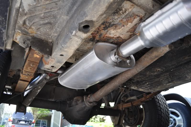

Pretty easy fix. Only had to make a few cuts, and it all fell out. Got rid of that terrible rattle caused by the heat shield, and she is definitely purring now.
Toughest part was getting the old cat off, had to make a diagonal cut along the intake and peel back with a flat bar, eventually it came off after some convincing.

kind clashes since its new and shinny everything else is rusty but looks like you did a nice job did you weld all the joints
