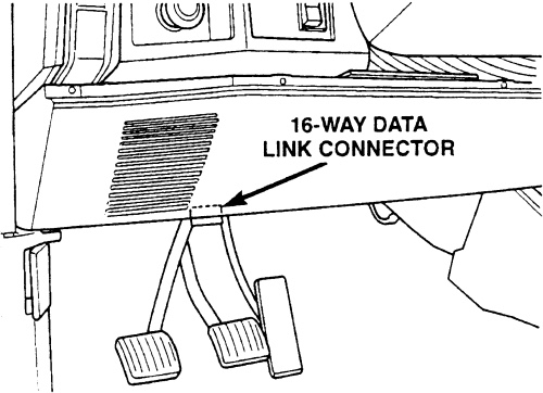

94 has odb port see below
yehaaa , the year was right. your diagram was wrong . Went to auto zone got one of the diagnostic things and went to plug it in . HUH, no plug in spot. then I learn I ave the wrong diagnostic toool in the first place. then I think I learn"LOL" the port is by the brake master cylinder, huh, tomorrows job maybe.
