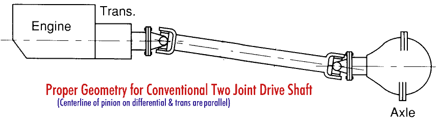

I installed a transfer case drop kit, and this greatly reduced my driveline vibration. Can I further reduce the vibration by pointing the rear pinion towards the transfer case? I installed adjustable lower arms, so it would be fairly easy to do.
Thoughts?
Thanks!
