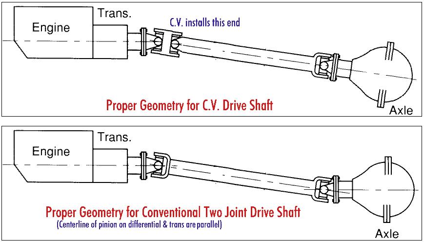

As to the driveshaft, you'll most likely need adjustable rear control arms (usually people get the uppers) to get the driveshaft installed correctly. The idea is to roll the pinion up, so that it points at the transfer case, like this:
Once you get this done, you should be able to drive your Jeep down to the alignment shop. You really need to have an alignment after lifting it. I'd suggest going to Firestone and springing for the lifetime alignment - I've used it about 6 times on my TJ so far.
