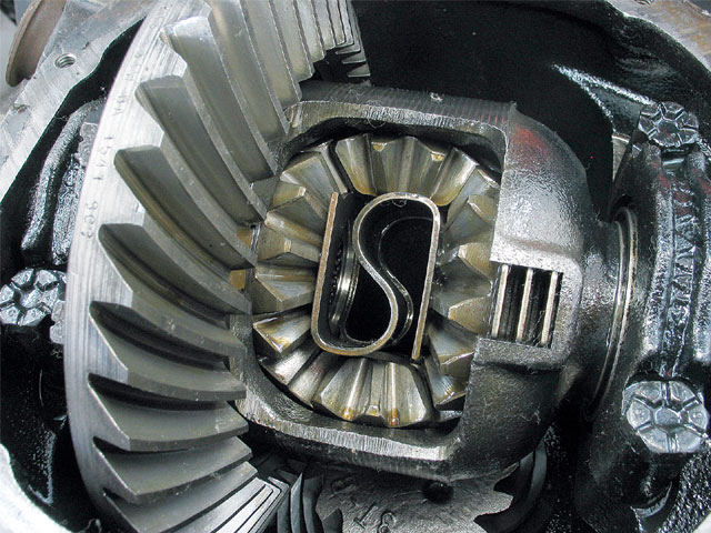

Here's what a popular limited slip diff looks like:
Yea defiantly did not have one like that in the front. I was at the parts store this morning and the friction additive was only about $3 so I bought it. Reading the package it says its good for all gear boxes not just limited slip differentials, so I figure I'll put it in the rear just to safe. Sounds like its good for the differential either way.
