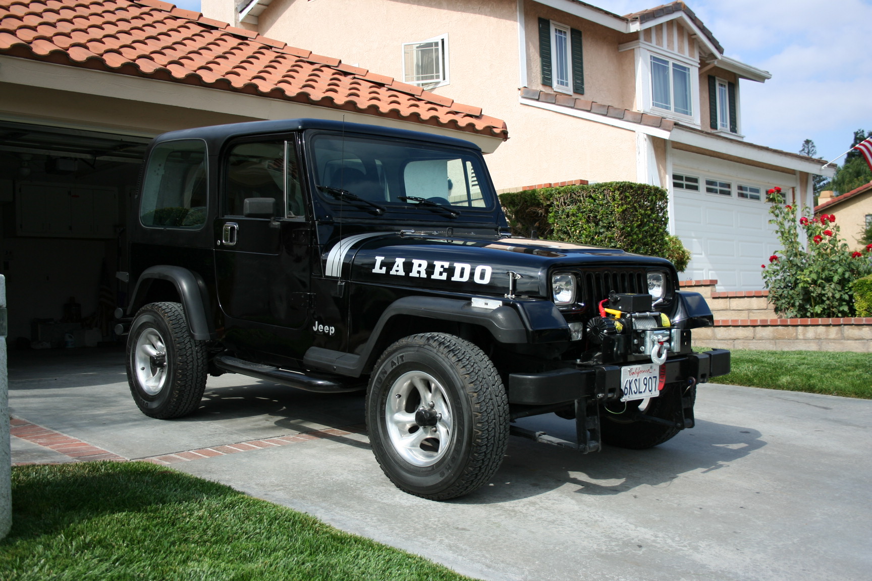

Mr recently restored stock 87 is great.I can roll down the highway at 65-70 and pull off road and play all day long. I have rebuilt the original carter carb and replaced the 30 miles of vaccum lines that were on it.I will be lifting it soon and adding 31x10.5,Howell EFI, It only has 103,000 miles on it and is solid.
man, those are some shackles on that good looking laredo. mine is an 87 also and runs great. jeeps got 110k on it and i am not sure on the engine but i know its less. the engine has the stroker on it from mixing a 4.0 and 4.2 with the original 4.2 head. strong runner, thats for sure. (now that the weber 34 is off it and its got another carb)
