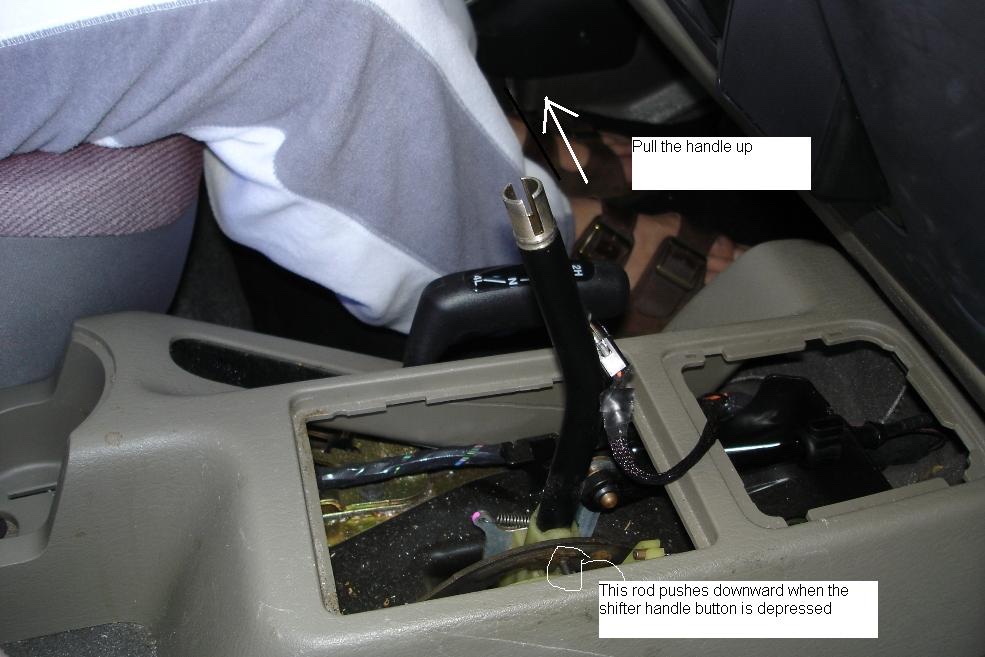

I think there is a plastic part in the shifter that breaks and causes issues. Lemme look and I'll post back.
NSS rebuild this guy has some nice videos.
Refers to the broken plastic part. Not his issue but worth looking into along with his fix.

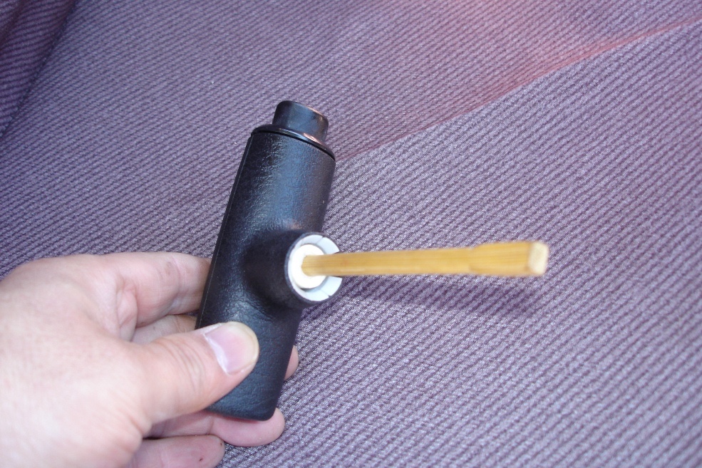

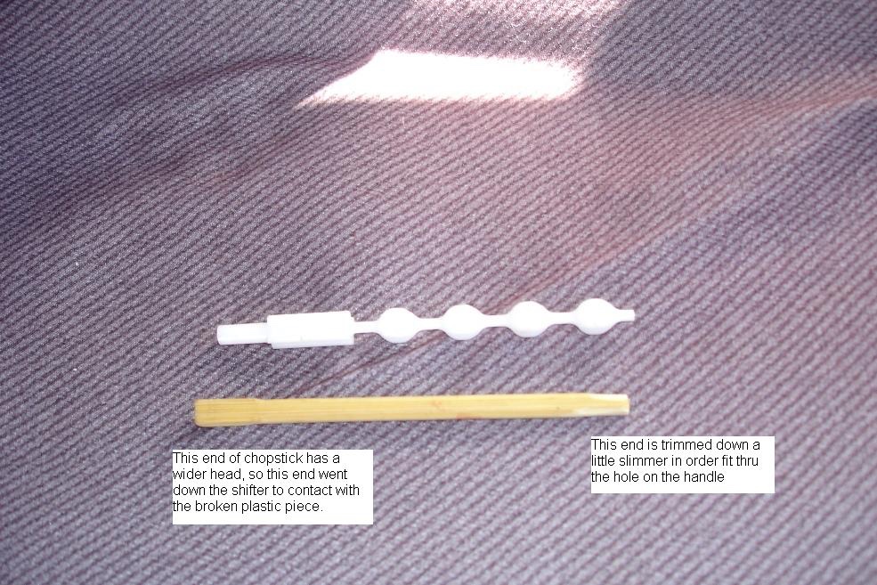

First verify the NSS is set properly. Being it worked properly before, this part might not be broken.
Chopstick fix:
Not mine. From somewhere else.
