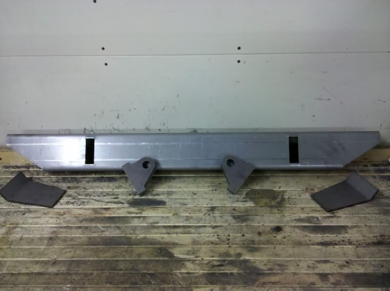

As you found out, no bumpers made out of 2x4. Just out of curiosity, what needs to be mounted for the strength? With these being made out of 1/4" there is more than enough beef. The only thing this design wouldn't be able to do is hold air (like a 2x4 can be boxed in as an aux. air tank).

I only have 2 of these bumpers left. Get one before I make my next batch and keep the Jeepz $20 discount, otherwise prices are going up do to the rising cost of steel.
Also if anyone is interested, I have this bumper available in a BYOB kit(build your own bumper). I have one kit left, and they sell for $95.

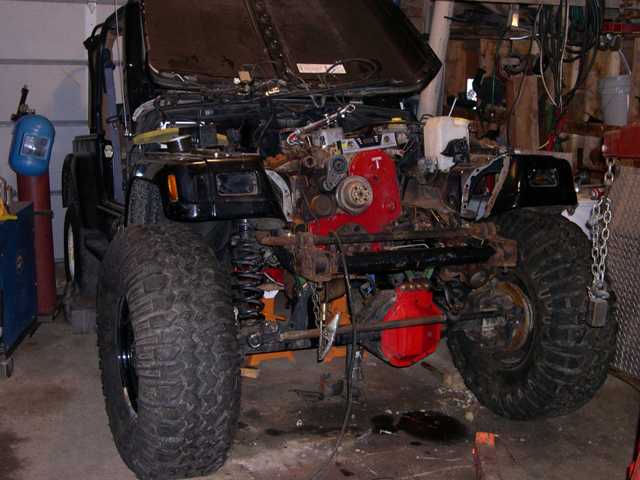

The steering box skid will not work on an Astro van box, thats why I mentioned I had that box. The pitman arm points forward so it is the lowest and farthest forward thus the first thing to get hit below the bumper.
Ahhh, it all makes sense now. Sounds like an interesting set-up. If you woudn't mind sending me a picture of it, maybe I can fab something for it?
I have none of my pics in my new hard drive. This is all I could find.
Dang! That does sit way down there:scratch: I was thinking that you could have just made a longer angled tab off the bumper to protect the box and arm, but that doesn't look like it'll work. You could just make the bumper come down lower and at a hard angle....make the lower 8 inches removable (for servicing the axle and steering). Sort of a bumper with an integrated front skid plate? Not entirely sure how that would look though?

Paul that idea is kind of what I had in mind. My pitman doesn't hang down quite that much. In that pic I have a 2" or so drop pitman arm and I have since gone to a regular straight pitman arm to get my geometry correct. I would also like to mount a 2" hitch receiver to the bottom of the bumper for moving trailers around and without it being supported on the backside I could see the receiver bending the bottom edge . So anyway, back to making one out of box tubing.
